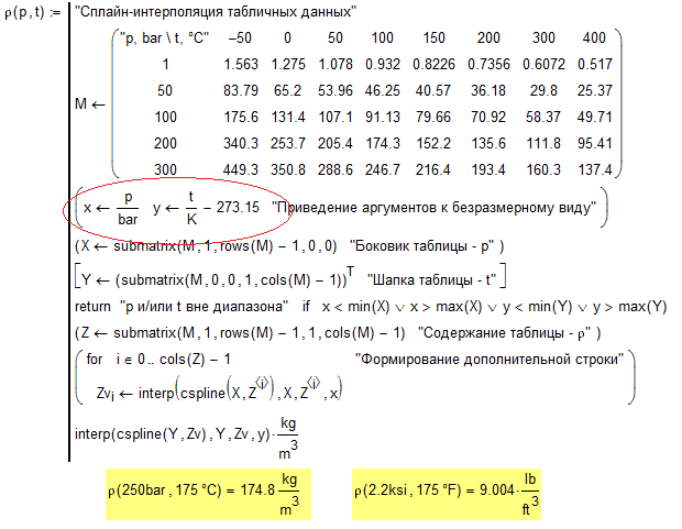

November 21, 2013
See one real task - air density:
