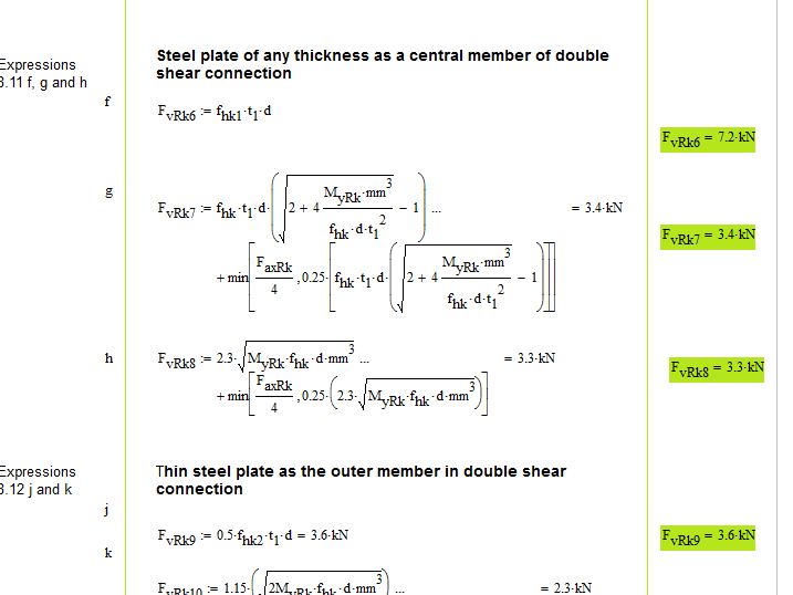

Are those function available in 2.0?
Can not find them
Addition with linebreak
Format font for variables - I can see only text format but what about results and variables and units - I want smaler font

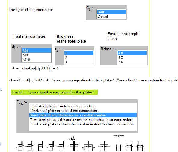

What about combo box or drop boxes?
I am trying to export form 15 t prime and the result is not good
Below snaps from 15..................

P3 will bring back user DLL and seems to use the same old technique as in older Mathcad versions. But components will still not be supported - so still no combo or dropdown boxes.

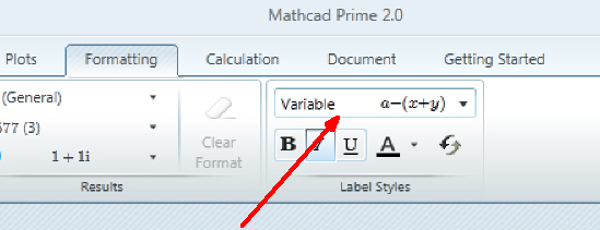

whatever the shortcomings of prime 2 may be, this one feature is working just fine. In the format tab you can define styles. Click on the pull-down menu and choose the topic (variables, constants etc.) you'd like to change.
Raiko
August 8, 2013
Hi Raiko
You can not change the size of the font or the type, only style of the font or color
This sheets are examples for EC5 design with our products hence I wanted to make smaller letters as you can not do anymore add with line break. Thanks for advise with programming Werner. I forgot completly aboy that.
It is a pity 2.0 is really development version not full functioning software. I wanted to make the examples in 2.0 so users for express could benefit. Looks no point really

I haven't been aware that you can't change font size in the style tab! So far I changed it to italics for variables and plain font for units as it is common in international equation writing. What a pity.
We'll have to wait for Prime 5/6/7...
