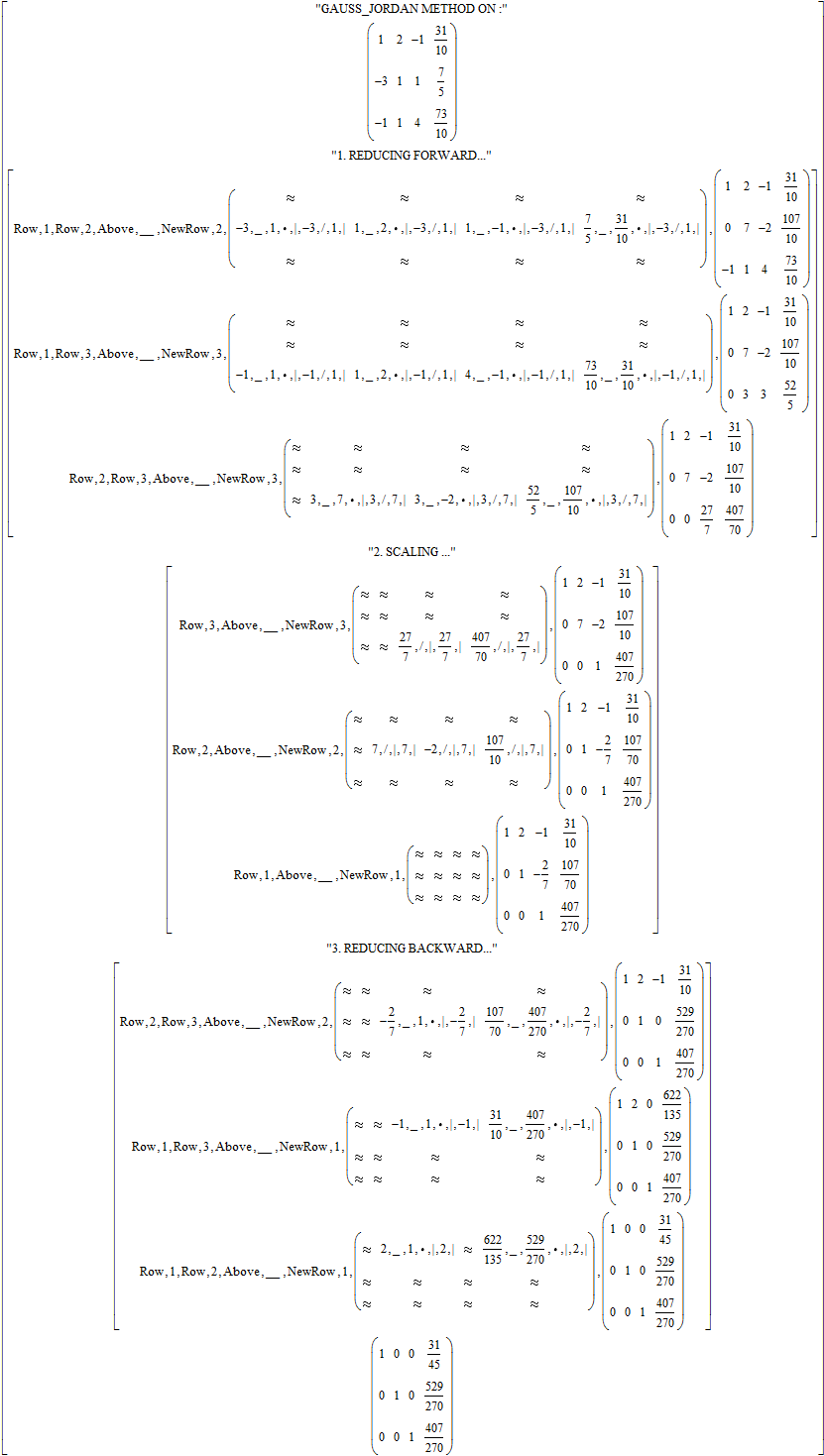

Really need help with these 2 problems:
Find the solution to Problems using the LU Decomposition method:
1.
X1 + X2 = 3
4X1 - 2X2 = 2
2. Find the set of equations for:
X1 + 2X2 - X3 = 3.1
-3X1 + X2 +X3 = 1.4
-X1 - X2 + 4X3 = 7.3
Thanks Guys!
March 15, 2011
Simply create you matrix M and apply the lu(M) function.
The manual gives details of the augmented matrix it returns, that is, it has the permutation P, L and U matrixes side by side in one big rectangular matrix.
The permutation matrix simply converts the original matrix M into an easier to solve (by the computer) matrix, for which the L and U are then provided.
In general, Mathcad is implicit (just use lu() ), rather than explicit (we don't write matlab code!)
It is possible to write a long(ish) programme function to do the pseudo code that may have been given in class, but usually we don't bother, given we have the function already 😉

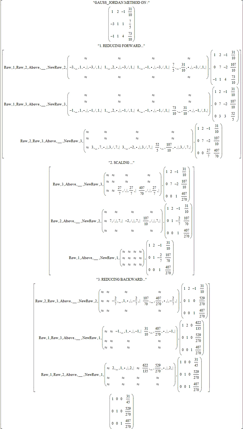

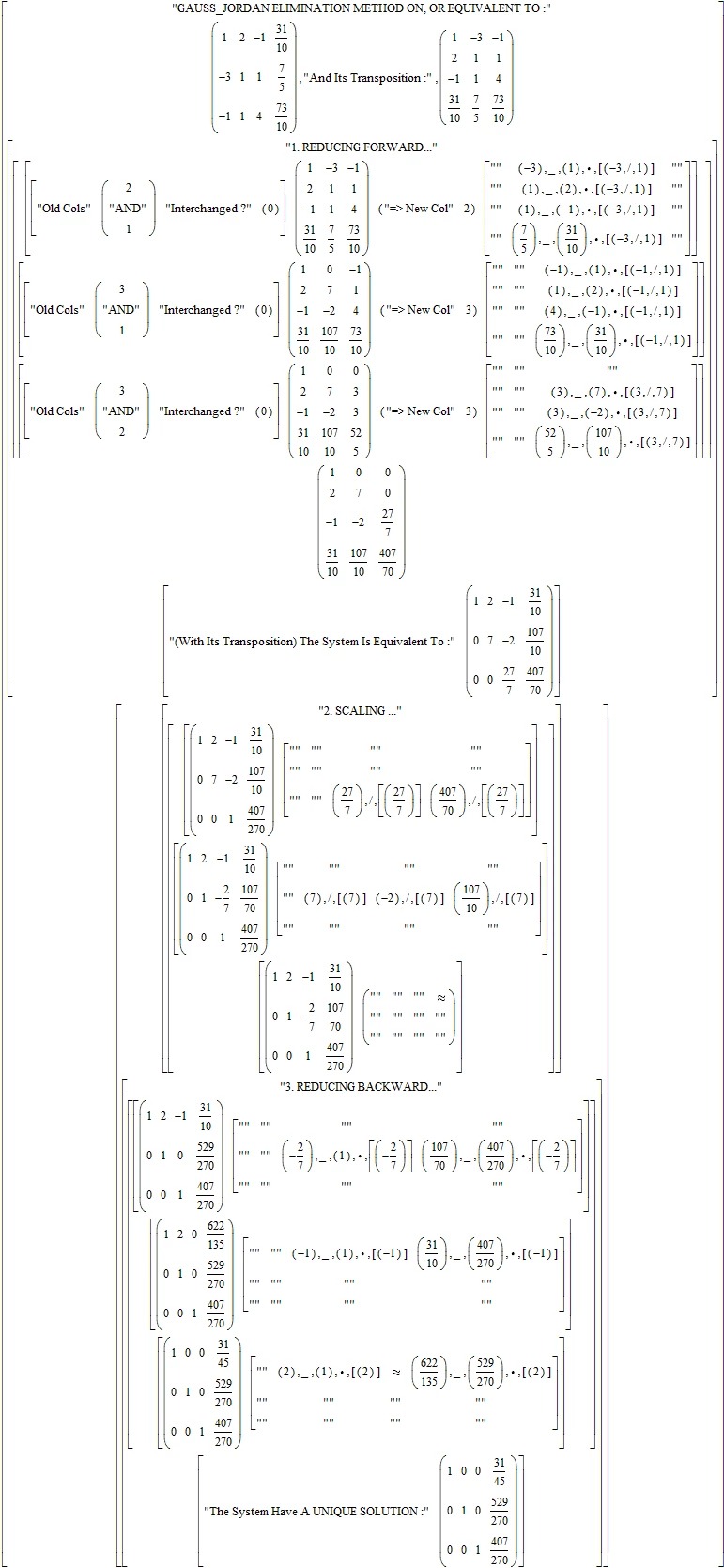

Maybe this is only a similar one.
20-Turquoise
December 30, 2011
A bit of editing the above.
