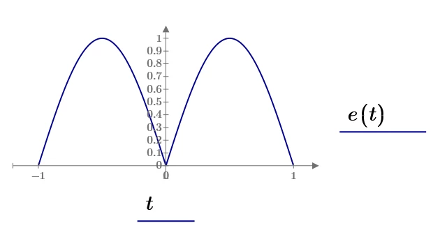

Make equivarent sine waveform that has maximum value = 1 and RMS = 1/sqrt(2).
Show another waveform that is equivalent to a sine wave with a maximum value of 1 and an effective value of 1/sqrt(2), and find its Fourier series so that the effective value of the Fourier series is 1/sqrt(2).
Below is an exsample of the answers.

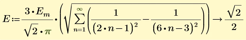

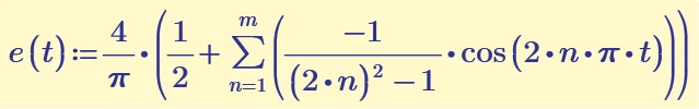

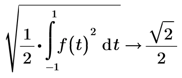

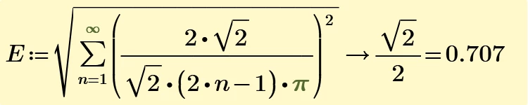

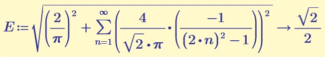

So here is the alternate signal:
May 6, 2025 1:17 PM UTC

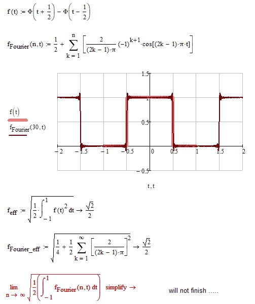

I'd be really curious to see how you get from em(t) with m->infinity to the expression for E using the usual RMS definition (integral) and the symbolic calculation possibilities of Prime 😈
Werner_E25-Diamond IAnswer
May 7, 2025 1:34 AM UTC

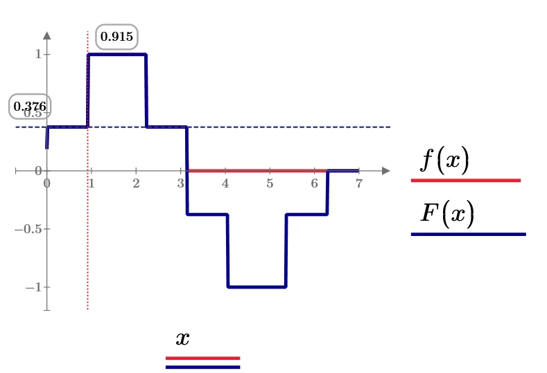

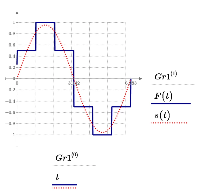

May 9, 2025 12:08 AM UTC

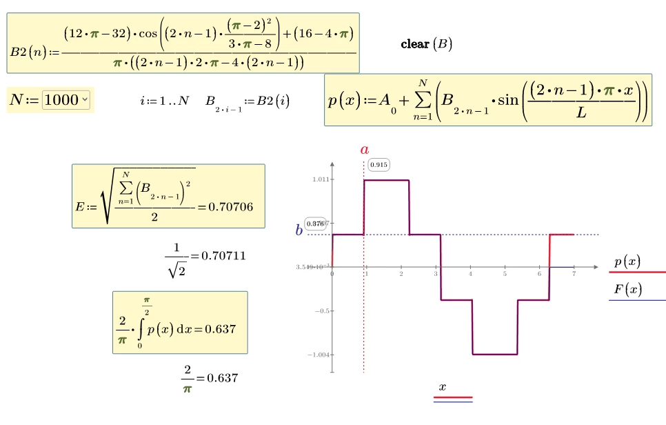

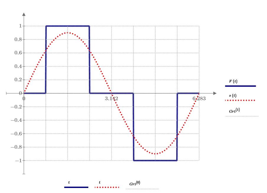

Chopped DC can make 1/sqrt(n) RMS waveform by 1/n chopping.
Another waveforms with same 1/sqrt(2) RMS are there. Red dotted lines are fundamental component of Fourier series.
If anyone has another waveform with 1/sqrt(2) RMS, please share here your waveform and Fourier series.
t.t.

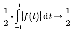

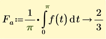

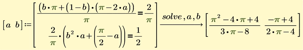

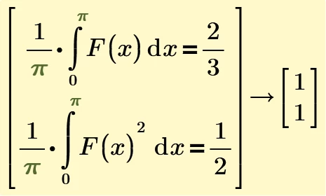

My above answers have Average values
So, they are not 2/pi of sine waveform.
Therefore, the next probrem is find RMS=1/sqrt(2) and Average=2/pi but not sine waveform.
