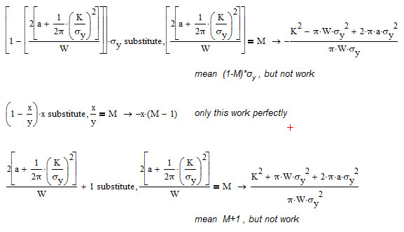

without units and using a substitution Mathcad is able to show the result, but I guess I won't make you happy. Due to the nature of the solution it cannot assigned a function. Details see attached.

I try to substitute it, but it can not work, even I try to substitute the simple one, it can not work too.

hehe, because I think the method of exhaustion maybe no efficency on this problem, so I have deleted the reply...
I'm use another method, simplify it by hand, and use W=1, plot K(a,W)--a/W, seemly it only one point on it...Maybe wrong.
