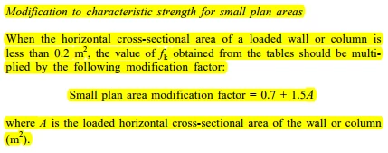

Quickly searching online, I found this:
Please verify this is what you are asking about.

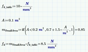

If so, then A should be divided by m^2 to get a unitless factor.
Edit:
Here is one possible implementation.

Yes thats it.
Thank u very much, simple solutions always work out best!
