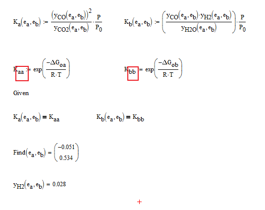

Hey. So this probably has a straightforward answer, but for some reason I can't seem to see what my problem is. I have everything in the right order for the solve block. But whenever I type in the K.a(e.a,e.b) after given, it tells me somethings up with my function.
There are a lot of annotations to this problem, its just how I like to do it. The real problem is at the bottom half.
Best answer by HarveyHensley
You have K.a and K.b defined twice, once as a function and once as a variable. Change the name of the ones with Gibbs energy and then change the names in the solve block accordingly. It works then.
March 26, 2012
if you can't tell, I'm trying to solve for e.a and e.b

Try this:
March 26, 2012
March 26, 2012
thanks!!!!
