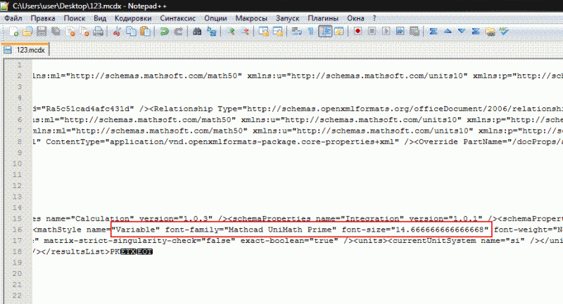

Well, to change font setting (type and its sizes) is possible only for text areas. But it is possible to look at what parameters of a font ("font-family" and "font-size") are used by default for styles of a designation "Variable" and "Unit". For this purpose we open file Mathcad Prime 1.0".mcdx" in the text editor, for example in Notepad ++ (http://notepad-plus-plus.org/) where we find a line "mathStyle" to refer to styles of "Variable","Unit" etc.:
July 25, 2011
That won't help with the formatting though.
Mike
July 25, 2011
I know it. After saving changes in a text editor (if we change the font manually), ".mcdx" file in Prime 1.0 will not open.
