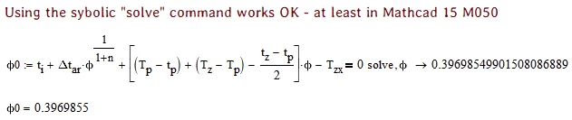

As Luc already wrote there was a change in the symbolic processor from Mathcad 13 to Mathcad 14.
And while I would say that MC14 is an improvment over MC13, this sure does not apply to symbolic operations. Maple as symbolic engine sure was the best engine Mathcad ever had and the successors (muPad since Mathcad 14 and FriCas/Axiom  since Prime 6) are clearly inferior to it.
Concerning the equation you try to solve we can say:
1) The symbolics seems to was improved over time. With the last version of Mathcad 15 (actually just a further maintenance release of MC14) I get

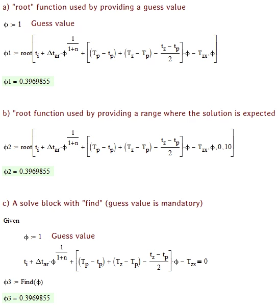

2) After you finally posted your worksheet it could be seen that all other variables in your equation are numerically defined - that means that you are just looking for a numeric solution, not a symbolic one! So there is no reason for using the symbolic "solve" command anyway.
You can use one of Mathcads numeric solvers. These basically are the "root" function (can be used in two ways) or a solve block with "find":
Mathcad 15 sheet attached, You should have no problems opening it with MC14.
The symbolic "solve" possibly still will fail in your version, but I expect that the numeric methods will work OK.
