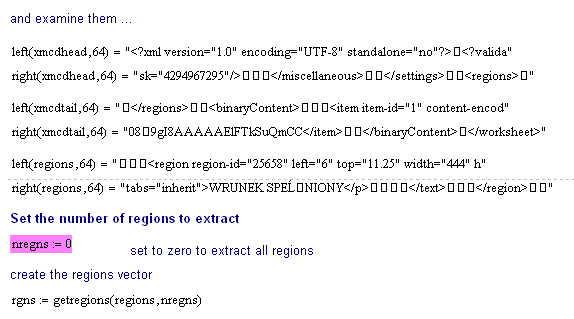

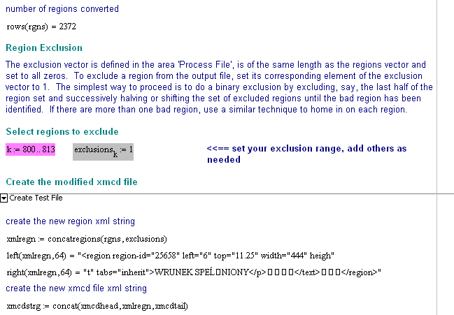

alright, I somehow managed to get the recovery file to read the name of my file. It cerated the .test file, but the problem still exist, the test file does'nt work properly. I think I dont get the idea how to extract regions. (I blame it on lack of sleep and language barrier, but still, I feel pretty stupid )
So, pretty dumb question: my recovery file now looks llike that:
How should I define variables nregns, k and exclusions.k to get this blasted thing to work?
Please, speak plainly, I have got hardly any sleep in days and i've got IQ of the zombie at the moment.
Thanks.

If I remember correctly Stuarts worksheet calculates how many regions are in the chosen file, then you define k as a range to exclude certain regions. You have to iterate through the regions until you find the problem region and the newly created worksheet opens.
Once you have found the problem region you can then start to reduce the range of k to increase how many regions are left in the worksheet. Remember to delete the created worksheet each time you run Stuarts worksheet.

Thanks a lot ! I seem to have gotten hang of it. It will take a while, but at least I got a big part of file back already. For all those who will get this problem later: nregns= is the number of regions that are left in the test file (counting from beginning) and all the rest is removed.

Allright, I managed to recover the file . Turns out that only region nuber 1115 out of 2400 was damaged. For all those others who have no idea how to use recovery file, little tutorial:
1. first only change value of nregns. First step: define nregns =x where x=0.5rows (regns). For example, in my file, I typed nregns= 1200 cause I've got almost 2400 regions. If test file is damaged, you know that the damaged region is in the first half. So, now you halve the number of the first half and type, as in my example nregns=600. It come out clean, so I knew I need to look somewhere between 600 and 1200. I gradually narrowed it down, half by half, and then I knew the damaged region had number 1115.
2. now, you need to remove that region, so , in my example, I had to type k:=1114...1115 and change exclusions.k=0 to exclusions.k=1. Then I typed nregns:=1200 and checked test file. It worked.
3. Now, you don't change k or exclusions.k, they stay as they were defined in step 2. You just amplify nregns until it reaches the rows(regns) number, which means your file is completely recovered, or you find another damaged region.
Hope this helps some other clueless chick.
