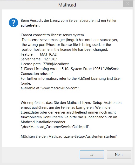

I try to install Mathcad 15 in Windows 8 64. But I get this errormessage.
Hope someone can help. Thanks
November 22, 2012
What type of license do you use ("floating" or "locked" license)? And also please see my comments here: http://communities.ptc.com/message/191657#191657
