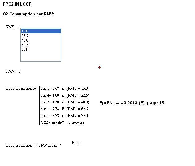

Hi guys,
List box is causing me problems... cant seem to find an example list box which does what im after
Im wanting RMV to show was whatever i select. I.e for above i should get 15.0
Simon
Best answer by AlanStevens
See edited List box script in the attached. There might well be a slicker way, but this works!
Alan
November 7, 2013
Alan
November 7, 2013
Slick enough for me Alan thanks alot !
