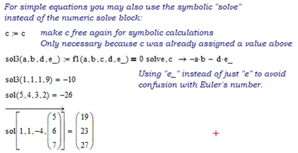

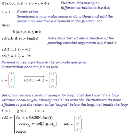

Hello all,
I want to solve an equation of one variable in combination with a for-loop.
In the appendix I added an example of this problem.
How can I solve this?
Thanks in advance!
Werner_EAnswer
The question is already four months old, but if there is still interest, find attached a way which uses your example and also a way to use the symbolic solve command instead of the numeric solve block.
MC15 worksheet attached

The function Find() can ONLY be used in a solve block.
Read the (online) manual (Mathcad help) from the menu.
23-Emerald I
If you set up your Given/Find block as  function--Ans(x):=Find(y), then below the solve block Ans(X) = will run the solve block for that value (X) and return that solution (Y).  This function can now be embedded in a for loop to return a series of solutions.
Werner_E25-Diamond IAnswer
