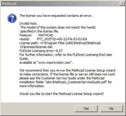

I tried to start Mathcad 15 and it gave me a license error. Specifically the host of the system doesn't match the host id of the license file. I'm using Windows 7 and haven't started Mathcad in several months. I'm on a laptop and recently switched to a new wifi router. That, along with any software updates is the only thing on the computer to change since the last time I ran Mathcad. The license path in the popup has my correct license path info and gives a flexnet licese error of -9,57
If i use the license wizard to configure the license for use it says the selected license has been installed and Mathcad licensing has been configured to use it, but it still won't work.

"Customer Number" and "Contract Number" must be included in your license file ("license.dat"). Open it in "Notepad". In addition to the license type "Locked" you also have "Home use" type in one license file? If the MAC-address of your network card has changed, then you will be able to generate a new license file using the option "Reconfigure Software Licenses" on the PTC's site, here: https://support.ptc.com/appserver/lm/rsl/reconfig.jsp

To be specific its saying this
A couple of other people have had thios problem and I could find nothing useful in those threads and it is a home license

Do you sometimes run your laptop with a wireless LAN connection and other times run it with a wired LAN connection?
December 29, 2014
Never, It has never been wired. The only chage was switching routers, from n which stopped working to ac. I was reading the administration guide in the license directory and the host id in the license id different than the one i get by following the instructions on how to look it up on my computer. I;m also pretty sure I have a locked license.
December 29, 2014
Strange. The reason I asked about the LAN connection is that it locks itself to the MAC address of your primary NIC. So if you license Mathcad with the wired connection enabled and the wireless connection disabled, and then disable the wired connection and enable the wireless connection, Mathcad won't run! In fact, your "host id" is nothing more than the MAC address itself. If you open a command prompt and type "getmac" you will get the MAC ids for all the adapters in your PC. Do any of them match the host id in the license file?
January 4, 2015
It started working on its own. One of the identical mac adresses changed back to what was on the license without me doing anything. And if it happens again, I found my invoice and saved it in three different devices.
