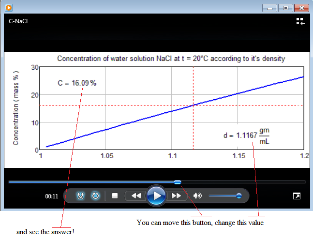

Mathcad can create stand alone executable programs - a video (animation) for example!
I have created a lot some programs for my colleagues-chemists!
One example.
You need to know the concentration of NaCl water solution. But you know only the density of this solution.
You can start the animation (alone executable programs created in Mathcad 15 - see the attaced file) and do it!

See the video:
Video Link : 3478
