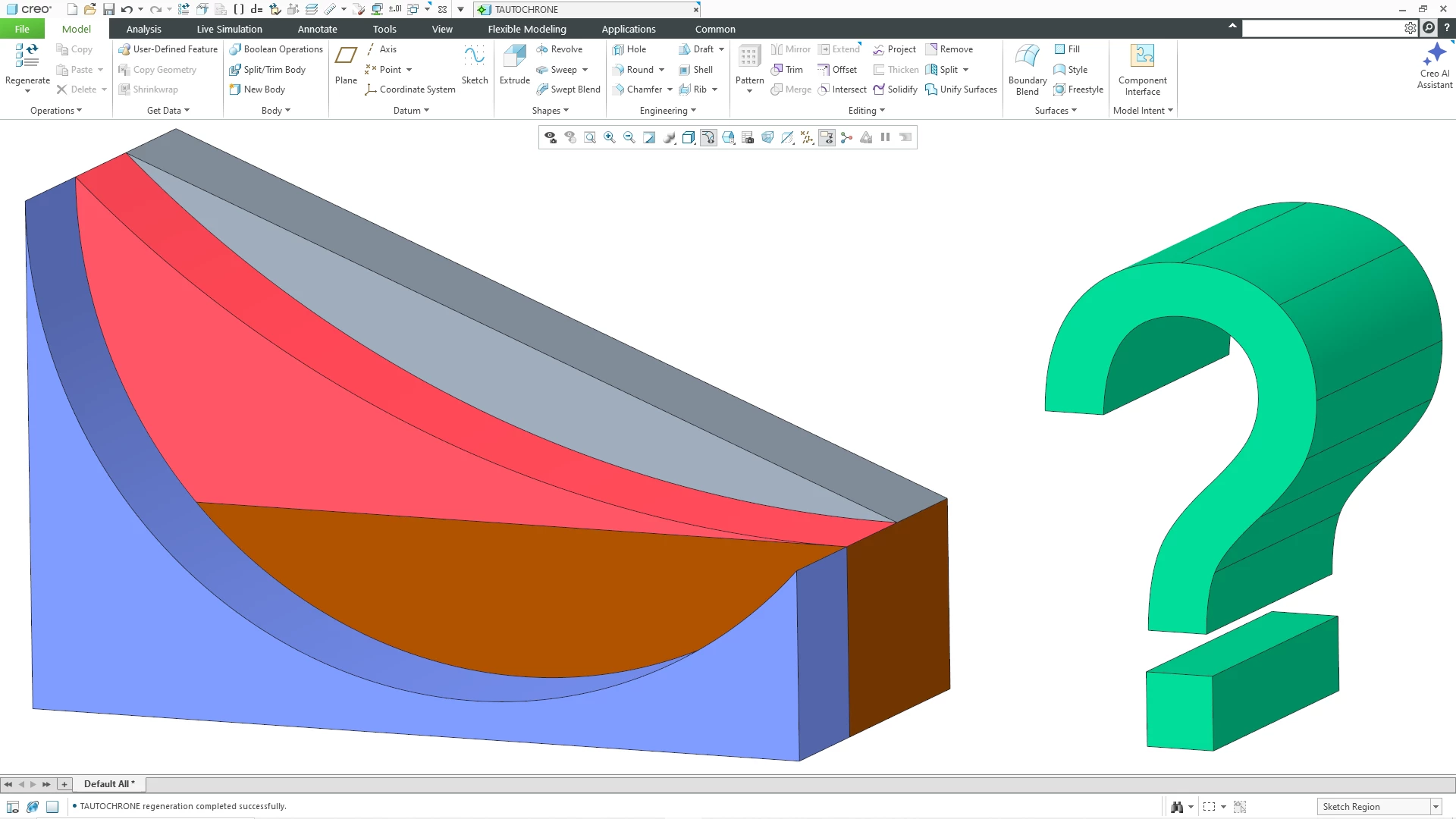

This month’s challenge is about tautochrone curves and isochronous curves. They are very similar. Both involve placing an object on the curve and allowing it to slide without friction. With a tautochrone, an object placed at any point on the curve will take the same time to slide to the bottom. With isochronous curves, objects allowed to slide from any part of the curve will have the same period of oscillation. You can think of the tautochrone as “half” of the isochronous curve, as it is only concerned with how long it takes the object to reach the bottom.
In this scenario, the “top” of the tautochrone curve is at a height of 10 meters on the left side. The end point is at ( 0, 0 ). (The “top” of the isochronous curve on the other side is 10 meters on the right side.) Design a curve such that an object placed at any point on the curve will take the same time to slide without friction to the end point under the effect of uniform gravity.
Examples of three possible solutions from Creo 13.

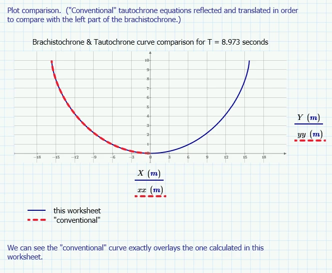

Challenge 6: How does the equation for the tautochrone / isochronous curve compare to the brachistochrone curve?

Here’s my weekend’s effort.
Prime 12 and pdf files in attached zip file.

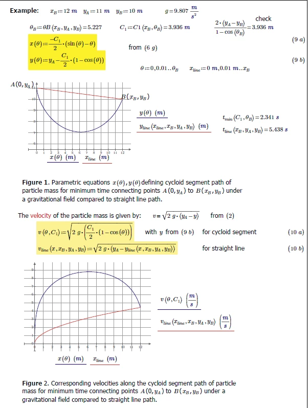

This is off subject, but I thought there might be interest in a Mathcad derivation of Brachistochrone curve (assuming this hasn’t already been done) and the calculation of the minimum time (which reduces to a simple formula) and the corresponding velocity curve compared to a straight-line solution. See attached.
