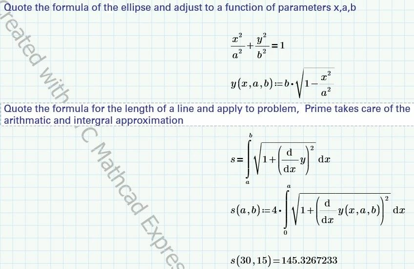

Mar 2, 2024 7:16 AM UTC
File enclosed Prime Express 9.0
Cheers
Terry

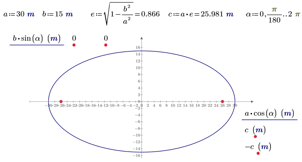

Mar 2, 2024 7:48 AM UTC

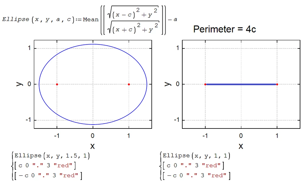

I once won such an argument a long time ago - I showed two ellipses (Mean) for which there is an exact formula for the perimeter. One of them is a circle, and the second - see the picture.
A more challenging and interesting problem is the Cassini Oval (gmean) and the Cayley Oval (hmean)!
PS
“The race course was a large three-mile ring of the form of an ellipse..”
Leo Tolstoy. "Anna Karenina"

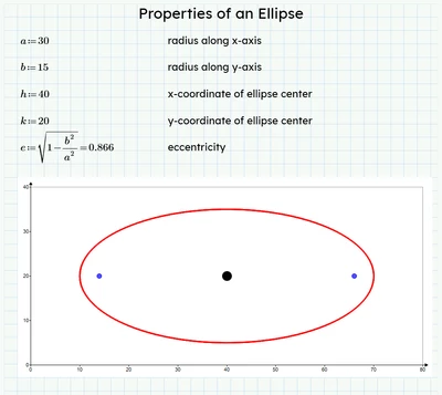

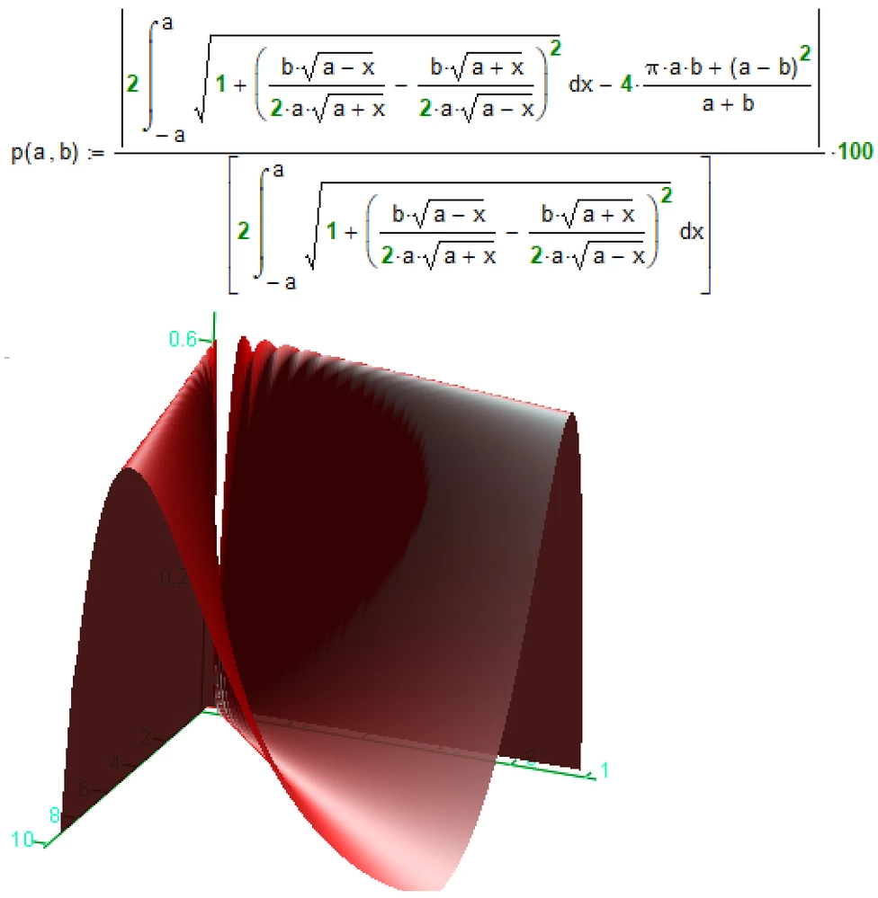

Mar 2, 2024 9:16 AM UTC
Mar 2, 2024 10:58 AM UTC
More interest plot

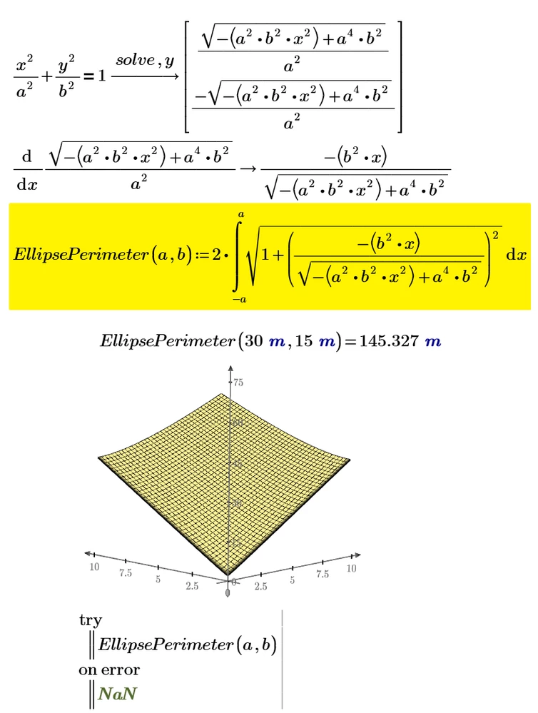

Mar 4, 2024 4:46 PM UTC
Am enjoying the posts so far so want to add a quick from 1st principles approach:

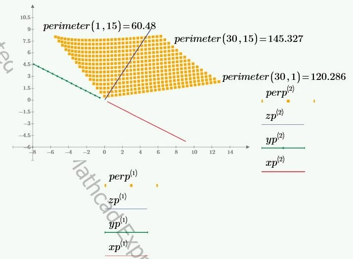

Just could not resist it.  A page of matrices and voila 3D plot in express.
Capture.JPG.

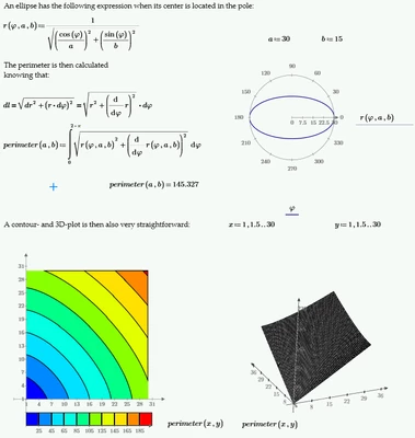

This is one I couldn't let go.  This question is easily solved using polar coordinates:
Calculation speed can be increased using the ellipse's symmetry by limiting the integral between 0 and pi/2 and multiply that value by 4.  With a similar technique surface, moment's of inertia and so on are easily calculated.
All this is pretty basic, really.  The fun starts when adding parameters to the equation, for instance making Superellipses and even (far) beyond.  In the following article I made use of Mathcad Prime to illustrate the above: https://www.athena-publishing.com/series/atmps/issbg-22/articles/260/view
Enjoy!

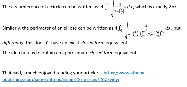

Mar 9, 2024 10:24 AM UTC
@Bert
Alan

"... which is exactly  ..."
exactly??  The perimeter of a circle can't be calculated exactly, either. 😞
The closed form for the circle circumference is actually a deception, because the infinite series is hidden in the constant pi, which we have invented for the  ratio perimeter: (2*r) for the ellipse with a=b=r.
So there is no real difference between the perimeter of a general ellipse and a circle other than the pi approximation key being available on every pocket calculator...
I, too, enjoyed Bert's article.

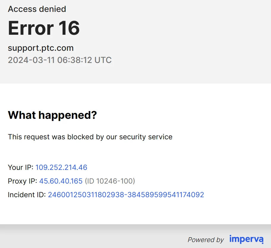

Seems to have been a forum ban (Val sent me the following image):
I assume this was an automated system response.  Perhaps an actual PTC person could overturn it?

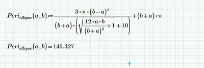

Mar 10, 2024 9:42 AM UTC
A friendly hello to the puzzle group,
I only have MC14 available. Therefore I couldn't read all the posts. Therefore, here is just a reference to a very good approximation function for the circumference of the ellipse - it is Ramanujan's formula. I don't know of a better one from the literature. I have attached them, but I cannot provide the desired 3D plot. I'm asking for help here.
Mar 10, 2024 11:50 AM UTC
Your function uu() has two parameters so producing a 3D plot is simple with the matrix() function.
Cheers
Terry
Mar 10, 2024 12:15 PM UTC
I use MC14 and therefore cannot load your file. Would you please reply in the appropriate file format? I haven't created a 3D plot yet. They were mostly vicious equations that I solved using equivalent minimum problems.

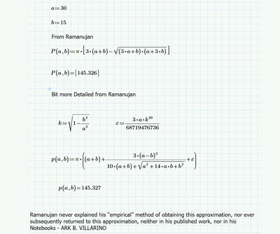

Mar 10, 2024 10:52 PM UTC
Using Ramanujan Approximation.
From MARK B. VILLARINO
192_05.pdf (emis.de)
Nice plots already done - see    AlanStevens
