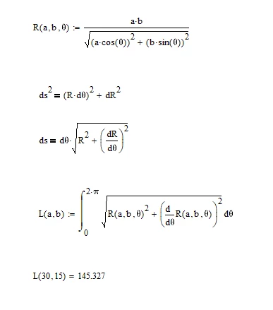

This isn't really a response to the challenge.  The attached sheet poses a slightly different question.
I started out to answer the challenge; seemed easy to simply integrate along the curve and easier to do it in polar coordinates:
For the ellipse posed in the challenge:
Then I looked at the other responses. . . .
And went back and checked, did the same thing in cartesian coordinates:
So why won't polar work?

Not the right expression for the kernel of the integral Fred.  Should be as follows:
Alan

Thanks Alan.
For pointing out my error.  I suspected it would be clear once it was pointed out.

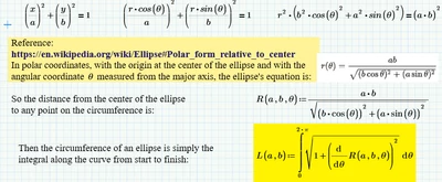

Hi DJ Newman,
I am not sure how to put this out to the PTC Mathcad community but here goes.
I know that the "community challenge for the perimeter of an ellipse" has ended but building on previous submittals, I though the attached might be of interest to the community. Especially in terms of the accuracy of the various methods versus numerical and symbolic solutions. See attached Mathcad Prime 10 results.
