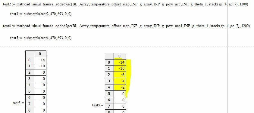

Hi, I build a DLL function and run well in visual studio debug and got the result as i want.
But mathcad load into this dll and try to run this dll twice with different parameter.
As below pictures,

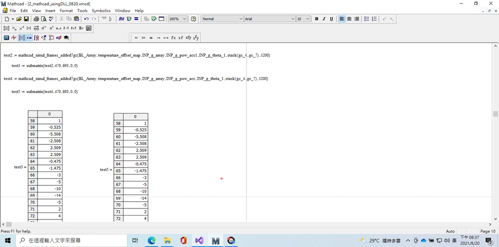

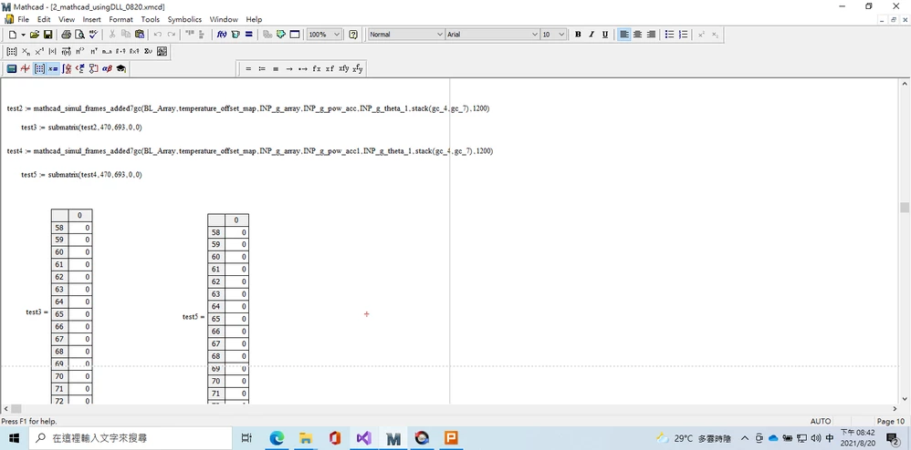

first, i load this dll twice with different parameter (INP_g_pow_acc) & (INP_g_pow_acc1), but got same result (this result is correspond to INP_g_pow_acc)
second, i exchange the parameter (INP_g_pow_acc & INP_g_pow_acc1), also got same result (this result is correspond to INP_g_pow_acc1)
Seem mathcad just load this dll once, how can mathcad run dll twice with different parameter??
Very thanks for your kindly support.

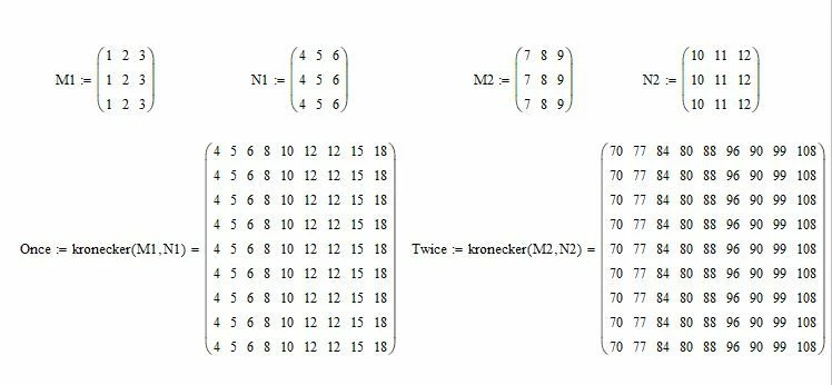

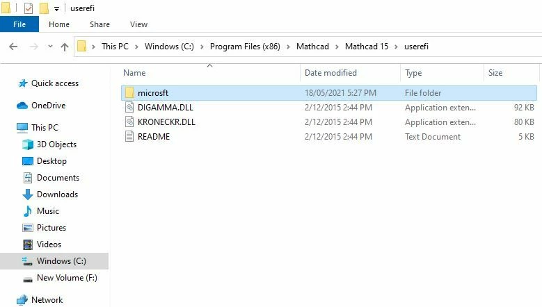

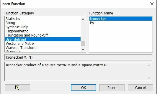

The kronecker function is an example DLL in the Mathcad distribution.  See Help | Developer's Reference
DLL can be found in the following directory.
Possible to use different parameters at each call.
Check your DLL. The double use of one DLL is illustrated at the top of the enclosed file.
Cheers
Terry
