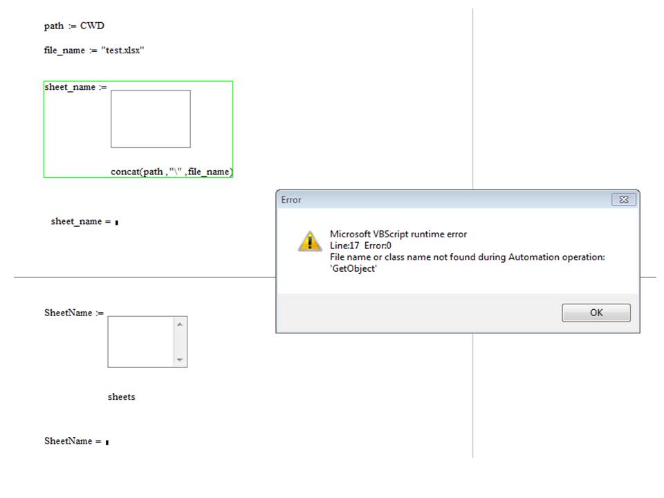

When I tried to opent the attached file, it gives VB Script error. See the attached screen grab
April 16, 2014
Obviously there is no excel file with the name test.xlsx in the current working directory.
