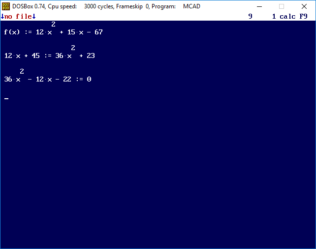

Ah, found what you're referring to. Here's Mathcad 2.50:
It is possible because I set the program to manual, that is, I enforced manual recalculation. In order to calculate I have to press the F9 key. And if I do that, mathcad complains that x is undefined for the equation that starts with 12*x...
You can get a similar effect in Prime if you click the "Stop All Calculations" button in the controls section of the Calculation Tab of the Ribbon.
HOWEVER: Prime will not allow you to enter equations like the second and third shown above, because it maintains that you cannot assign an expression to a calculation; which is a reasonable restriction. Also recent versions of Mathcad (no Prime) will not allow that. I don';t know when this was abandoned, but it may have been thrown out already at version 3 (Mathcad, not Prime).
So if you still want to enter just expressions and to the manipulations yourself, use the boolean equals [CTL-=] to write your equations. And as Mark has shown, recent versions of Mathcad, and also Prime, have the ability to symbolically work such expressions.
I haven't found the "EQU" command in Mathcad 2.50 yet. What would it do?
23-Emerald V
October 10, 2016
Ah, found it. It's called "eq" and esentially sets to disable evaluation of the expression. It appends a small box at the end of the equation.
