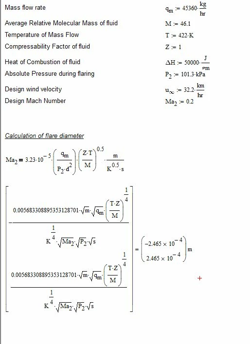

I am re-creating the appendix C of calculations to size a flare system, however I can't seem to get MathCad to correctly solve for my variable. I've swapped out units and values but I still don't get the correct answer.
I have uploaded the output from MathCad
However, the answer I am supposed to get is d=0.468 m. Not too sure how to make mathcad only give me the positive answer though.
Best answer by Werner_E

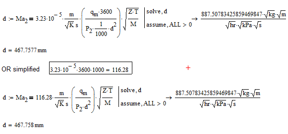

As Valery already pointed out that formula in your Appendix is not quite clean concerning units. The example given there is calculated dimensionless, as Valery has done.
I would correct the fact, that Ma2 has no unit by assigning the constant 3.23*10^(-5) the appropriate unit. I'm not sure about units of Z and esp. M !??
The reason you are not getting the answer you expect is, that qm and P2 are not using basic SI units. You may compensate by multiplying qm by 3600 (kg/s --> kg/hr) and dividing P2 through 1000 (Pa --> kPa). That way you have at a formula with a constant of 116.28 you may use with data of any units (as long as your worksheets units are set to SI units in preferences).
To get only the positive solution you would normally use the modifier "assume, d>0", but the symbolic engine does not know anything about units at all. Thats the reason you see kPa, m etc. in the symbolic result - the symbolic engine sees them as unknown variables. Because of that I had to use "assume, ALL>0" to make it work.
Hope it helps.
BTW, is there a specific reason you are appending the literal subscript point to the names of all variables which do not use subscripts ("Z." instead of "Z", etc.)?

Are you missing DEL H in your calculation? You have it defined but not used.

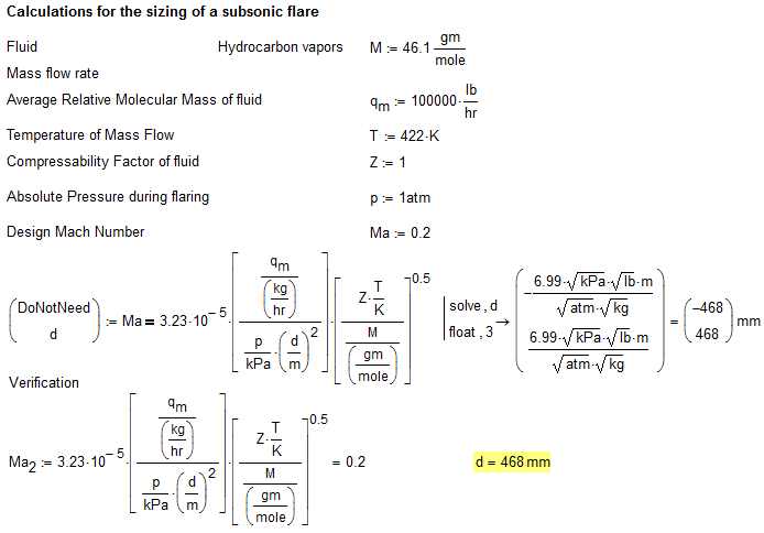

I think you are using dimensional variables in an equation that already has a conversion unit.
See the attached.

February 2, 2013
What I see is a correct Mathcdad evaluation.
Why do expect somoethings else?
You will get better response if you attach the worksheet. You don't expect us to type in all that values, don't you?
????????? appendix of WHAT?
Sure not with the formula you have typed in the screensot, check it against the books
What do you mean by that? You have neither used a solve block nor the symbolic solve. You have typed in the vector which gives you the negative result as one of its two elements yourself!?

February 3, 2013
I hope it help you - see please the picture and download the attached sheet.

I know this is probably "beating a dead horse" but I would like to point out the differences between the three methods given. My motivation has nothing to do with who is right and who gets credit.
The method Werner provided developed a new conversion constant that is specific to the SI system, as he said. If a user changes the base system, then a new constant will be needed. Coming up with new constants increases the chance of error and makes the worksheet less universal.
The methods Valery and I used will work regardless of the base units. Valery's method (dividing each variable by the specified unit) is the best way to conform to the original equation. Also, this is the best way to use empirical equations which could be using a mixture of unit systems. This method means that the constants in the equation do not need changing. That could be desirable if you have to show adherence to a code.
My approach (showing the fundamental equation), is useful if you desire to show the the full equation with all constants and variables (e.g. Rg, k). However, it too could increase the chance of error if you don't "get it right". In your case, we had a known answer for checking the result.
In the long run, Valery's method is best for quick use of a published equation. If you are developing a procedure which would benefit from full explanation of all equations, then converting the equation to the fundamental form would be a better choice. In the case in question, this approach also made the equation more general by not assuming k=1.
