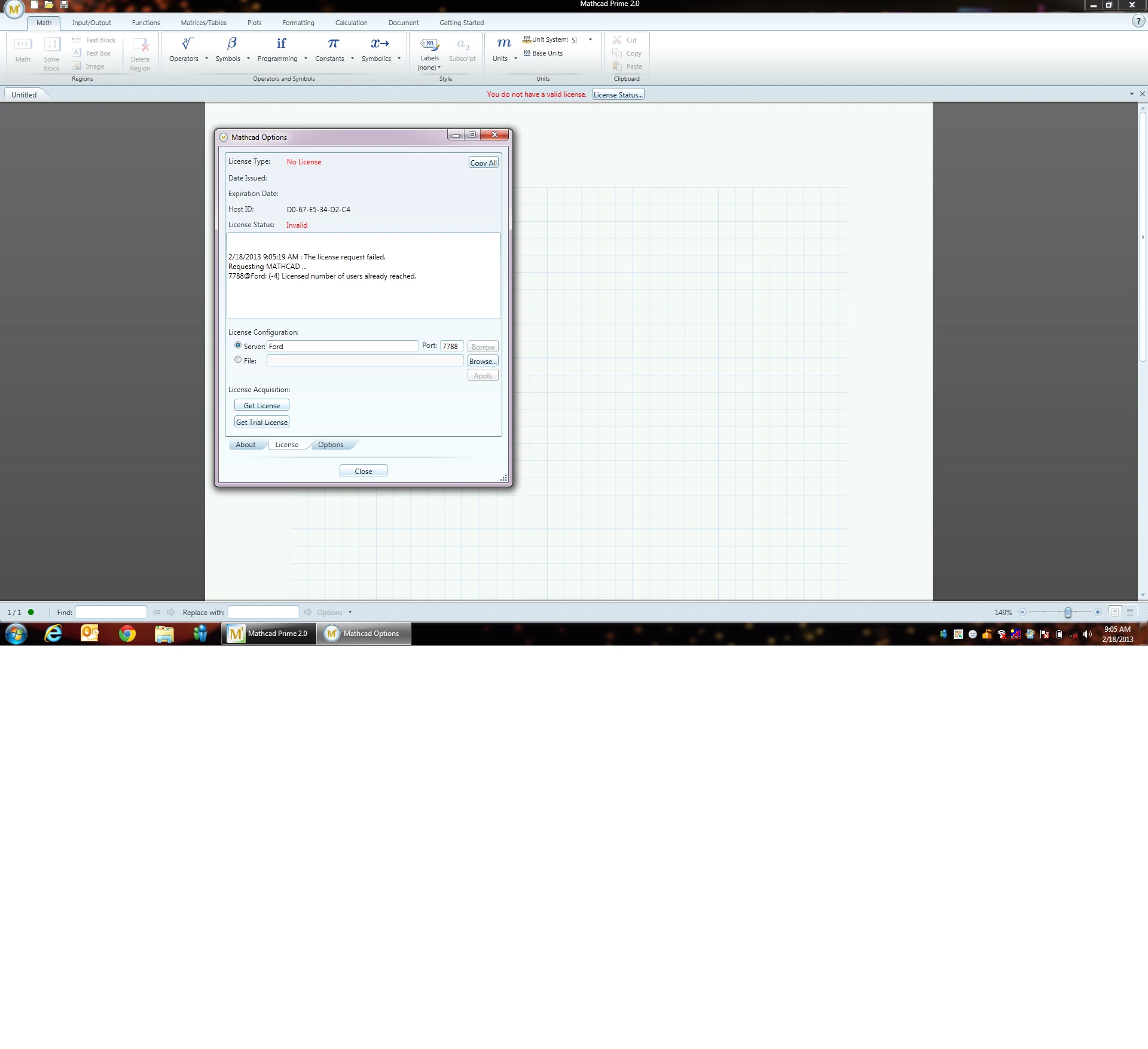

To Whom it may concern:
Hello everyone, can anybody help me about this this little concern.
Even though all the client PCs along the network is already shutted down,
my MATHCAD software cannot obtain a valid license (Floating License),
it says License reached number of users.
Thank You,
Rizford
Best answer by Werner_E
Unfortunately shutting down a PC does not necessarily mean that the license is put back - especially if the PC is shut down without closing Mathcad.
One other thing which could be the cause is that one ore more clients could have borrowed a license. This give them the ability to run mathcad without having acces to the license server. I can't look for it at the moment, but I think a license can be borrowed for up to two or three weeks. In Prime, I think I can remember, you have no choice, the license is borrowed for two weeks unless you put it back sooner manually.
So unless there is some problem with your license and/or license server this could be the cause.

February 18, 2013
Thanks Werner for the reply, i will try to check if these client PCs has accidentally borrowed a license.
Thank You,
Rizford

February 25, 2013
Thanks again i have solve the issue, its due because the user accidentally hit the borrow button.
Thanks also to Vladimir for the additional info.
