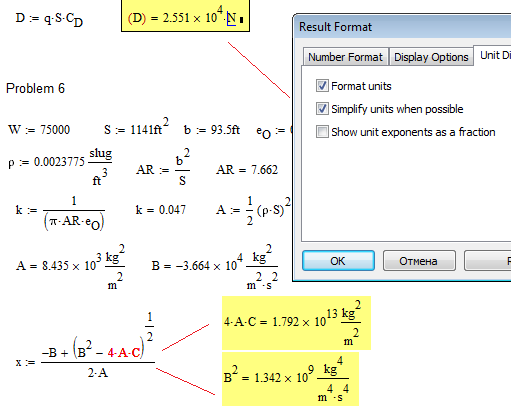

Whenever I use a unit such as Newton or velocity.... anything that has a "per second", MathCad multiplies it incorrectly. If I type out m*sec^-1 it works. Why is this and how do I fix it? It is very cumbersome when working with lbf and newtons.

You don't have W defined as a weight. You have it defined as a dimensionless quantity, which is not a weight.
Are you saying the quadratic is
where x=v^2? Where did this come from? Either the units in all the terms must match, or it is empirical (i.e. not derived from physics, but calculated by fitting a quadratic to measured data). Or, of course, it could just be wrong. Is this an empirical formula?
In the Mathcad worksheet it says "Problem 6", and I assume this is the answer. In which case it might help if you posted the problem.

Can you post a worksheet or image with an example of what you mean?
November 8, 2012
I attached the file. The top part of the problem is worked by saying m*sec^-1 while the bottom is not.
If you look at the value for B... it is apparent that the seconds did not get moved to the top like they should have.
November 8, 2012
See the picture:
November 8, 2012
So what am I supposed to do exactly? I have the same menu values checked as you do, but nothing has changed.
