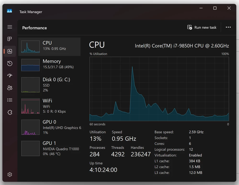

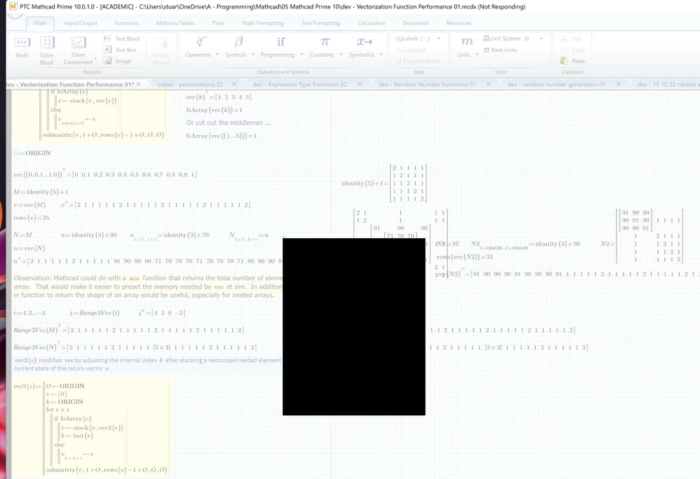

Mathcad Prime (MP) 10 starts to become unusably slow after switching between Mathcad and other applications (even Character Map or its own windows (eg, right-click context or worksheet list drop-down).
It usually manifests as unresponsiveness after switching back to Mathcad from another app.  Mathcad will freeze, unfreeze, and then freeze again before resuming normal service.  At the moment, though Mathcad is just cycling through freezes and won't let me do anything (including saving the active worksheet).
It seems to happen quicker when I have multiple worksheets open, even if those worksheets do not require saving or have any edit actions that might need undoing.
It happened in the initial MP 10 and in MP 10.0.1.0, but I've noticed it more in MP 10.0.1.0.
Stuart
Edited to add:  My Dell laptop doesn't appear to be overly strained during these freezes.

@StuartBruff wrote:
Thanks, Martin.
That core loading is interesting. How many worksheets did you have open at once?  I tend to have several open at a time so that I copy code from to another, maybe tinker with the code to meet a new situation and paste the code back to its original worksheet.   I think I had 7 worksheets open the last time the laptop started playing up (or down, in performance);  Mathcad said it was using about 3.5 GiB and the rest of the processes on the laptop were taking up about 13 GiB, so just over 16 GiB out 32 GiB being used and no evidence of hight peaks.
