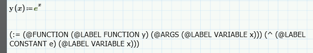

May 29, 2013
Copy in text box (not Mathcad 15 and Prime 3.0)
May 29, 2013
Right, that's the format, but I'm looking for the full spec that documents every element of that format.
