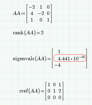

mathcad prime 2.0 matrix functions' bugs
mathca15.0 result:
else functions such as:rref has the same bug

What happens if you raise the zero threshold  in Mathcad 15 to a higher value (mine shows up as 15, raise it to 20)
