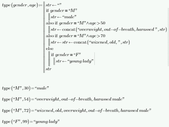

Forget the above example, alsoif will evaluate the condition regardless of whether the preceding if or alsoif statements were true.

We added both elseif and alsoif for compatibility with earlier versions of Mathcad. Alsoif is like a series of if statements.
From Help,
When you use elseif, the program stops evaluating statements when it reaches the first true statement.
When you use alsoif, the program evaluates all alsoif statements. If any of them are true, the program does not evaluate any of the following else statements.
