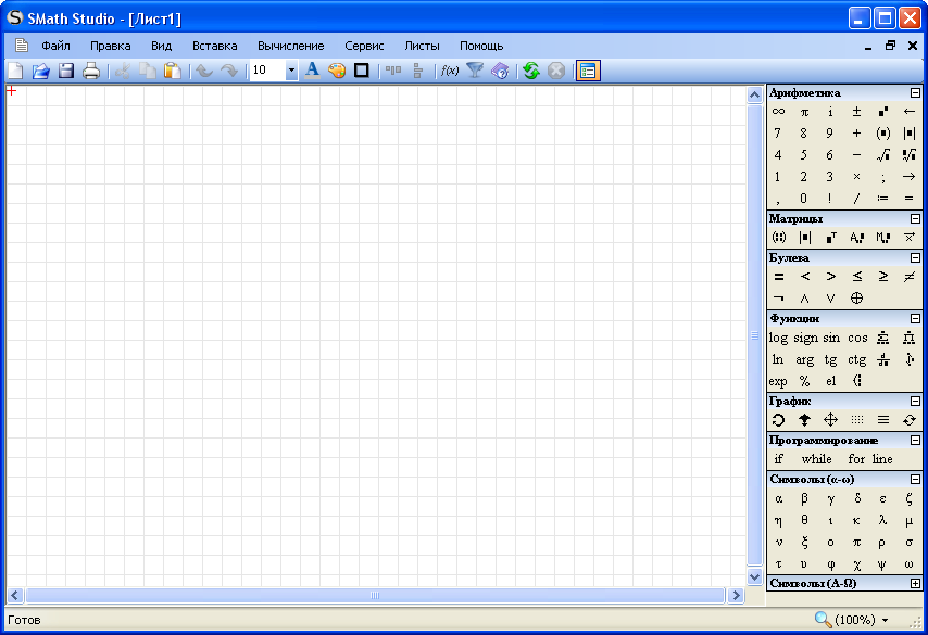

There is a "russian version of Mathcad" for Linux and for some Pocket Computer too - see http://en.smath.info/forum/
