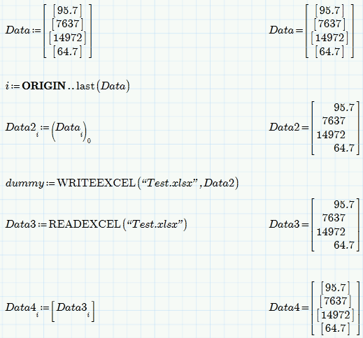

Of course you would first have to create a structure compatible with Excel and you would have to decide how you would like your data be presented in Excel.
November 24, 2013
Look if the attached would help.

Thanks for the suggestions, I'll look at them. My nested array can vary in the number of rows, depending on the case study, I figured if someone could show me how to send one row to Excel, I could then manage from there on.

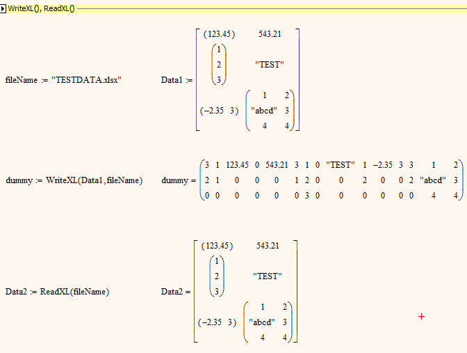

In case you still are in need for routines to do the data exchange between Prime and MC you described, here are two routines, WriteXL() and ReadXL(), which will work on nested arrays (nest level 1 only).
It was written in Mathcad 15 for the very same reasons you described. I guess you can convert it in Prime format yourself. While Prime2 and Prime3 can coexist, the installation of Prime3 killed the Prime2 converter which doesn't work anymore. So I could only convert it in Prime3 format and there is no way to convert it back in P2 format. Its a PTC software :-(.

Thaks for your help, Werner, you've been a terrific help!
Brad
