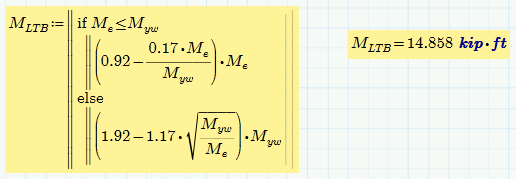

See attached spreadsheet.
I am trying to set up a simple if-otherwise statement and I am running into some trouble.
1.) I am not sure if it even set up correctly
2.) I am getting an error reffering to scalar vs. matrix.
If Me< (or eqaul to) Myw use first equation. (0.92-.17*Me etc.)
If not, use the second one (1.92-1.17etc.)
Any help or input is greatly appreicatied.
Thank you,
jReck
Best answer by Werner_E
No, you didn't.
Because you tried to multiply the first expression with an if-construct.
See attached.

Werner_E25-Diamond IAnswer
December 31, 2013
No, you didn't.
See attached.
December 31, 2013
Better use not the operator but the function if.
We can use in this case the free Mathcad Express!
Happy New Year!
