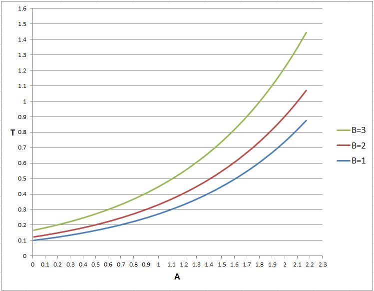

Now I want an XY plot graph that shows A on the X axis and T on the Y axis. And then show multiple lines depicted by the changing of B.
So the graph would have lines for each value chosen for B and plot each line with A changing and the output of T.
The sheet is just one set of equations for a single input and a single answer output.
Is there a way to take that and have the inputs varied and plot the outputs as described above.
What steps or functions on MathCad Prime 3.0 would I have to do to make this possible.
Here's an example of a graph I would hope to get. Thanks.
October 23, 2013
The graph you provided does not reflect the equations you have given.
Would something like the attached help?

Your right the graph I posted doesn't the match the equations. It was just a quick example as was the equations.
The file you provided helped with adjusting the file I have to get what I needed. Thanks!
