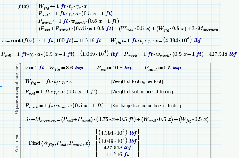

I'm trying to use the solver to solve 4 unknowns with 4 equations. I keep getting the error "No solution was found". I can work the answer out easily enough by hand and all the similar examples I have found seem to work just fine. What am I doing wrong? Help!
Best answer by ptc-6027190
Ah! Silly me. Solution found! The M_overturn value needs to be a positive value in the final constraints equation.

See please the attach - no solution
May 13, 2014
Sorry, You have not 4 but 1 equations:
