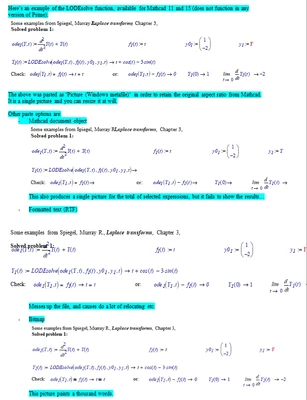

I generally NOT use Prime, but Mathcad 11. That's unfortunately not an option for you, but you (still) can use Mathcad 15, which should be capable of similar options as shown below (a screenshot of a page in MsWord I just assembled, the text I typed in MsWord is on a blue background):
As you will guess, I generally use the first option.
The 'Mathcad document object' fails to show results probably because I have automatic calculation turned off by default. This option embeds the Mathcad sheet file into the MsWord document. Now if you have several pieces of a single Mathcad sheet that you want to put scattered over your MsWord file, you are embedding the same sheet several times, each time with a different view on the embedded sheet. I think that's a problem. The other point is that if you resize the 'picture' (= the view window), the Mathcad regions start to move.
The picture in this forum isn't as sharp as I see it on the screen. The MsWord file is attached, so you can see for yourself.

I think 'awfull' expresses a sense of (dis)taste, and taste is a debatable matter. Prime copy to MsWord paste can only be done as a bitmap. As long as you don't mess with that bitmap (keep it the same size and aspect ratio) the result may be OK, although the edges of the font characters are not as sharp as you might want. You should try changing the font (in Prime), this is Times New Roman:
instead of the default:
