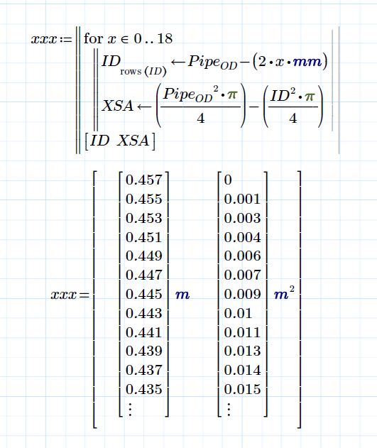

January 27, 2011
If/when my company converts to using PRIME, I'll probably return to writing short programs that return multiple values (ie moment, shear and distance) each with their own units. I do miss that ability from the MC11 days.
Preston
January 27, 2011
That's a good example Preston. I assume you'll also like the new feature Prime has which allows multi unit tables.

January 27, 2011
A good improvemnt in Prime shown below as Preston indicated.
The problem is that the second column can't be changed from base IS units , but still I would consider this a massive improvemnt from M15.
Mike
