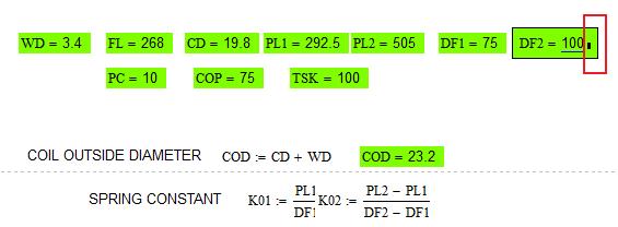

I have a spring calculation done in Mathcad 15.0. I am integrating the results with Pro/E wildfire 5.0 for creating the spring model.
I try to create a variant from the part file by creating a back-up from the created partt file and changing the input values, adding further more calculations to the existing sheet.
If I do this the relations are getting distorted. I get a warning that relations is having errors.
How to correct this?

Could you show a screenshot of this error?

Vladimir,
Find the attached screen shot.
Dhinesh

You used tags for data transmission "mc2proe" and "proe2mc", but just forgot to specify also near to value and units of measure in Mathcad! Without them integration will not work.
