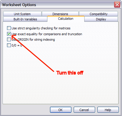

Mathcad is adding a very small number to my results. There is no explaination for it. I am using Mathcad 14.
I have attached both the Mathcad file and a PDF (in case you are not running v14).
If you don't feel like downloading the attachments, this is the jist of what is happening:
Why would Mathcad add in that 10^(-14)? The problem is I want to do something similar to the following: . My equations don't work with imaginary numbers!
I tried increasing the Worksheet Options to 1e-020 for both TOL and CTOL and neither corrected the problem. What is happening?!??!?!

I copied equations from Mathcad into the post which showed fine before submitting, but they didn't show up after submitting. So my post may be a little confusing. I also did not see a button to edit my original post. Therefore, please see the following correction:
hn = 99*ft
n = 10
hincr = hn/n = 9.900000000000000000*ft
hincr*10 = 9.900000000000001000*ft
Why would Mathcad add in that 10^(-14)? The problem is I want to do something similar to the following: sqrt(hn-hincr*10)= imaginary number. My equations don't work with imaginary numbers!
July 14, 2011
Looks like a bug to me.
Mike
jfluckey1-VisitorAuthor
July 14, 2011
I thought so too. There is also no way around it that I have found. I tried to redefine variable that had the anomaly, "x", to Floor(x,0.00001*ft), yet the error is persistent.
