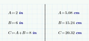

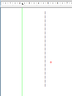

Where on the page do you want that line?
Must it be visible when printed (see black one below), or do you need just a 'guide' line (the green one)?
sroy-41-VisitorAuthor
May 11, 2016
Like the black line (that I would like to see in the print version), and not the guide line. as the green one. I am using Mathcad Prime 3.1, but would be interested to know if this is possible in version of Mathcad.
Thanks.
May 11, 2016
I could be wrong, but I don't believe Prime has the guide lines (green).

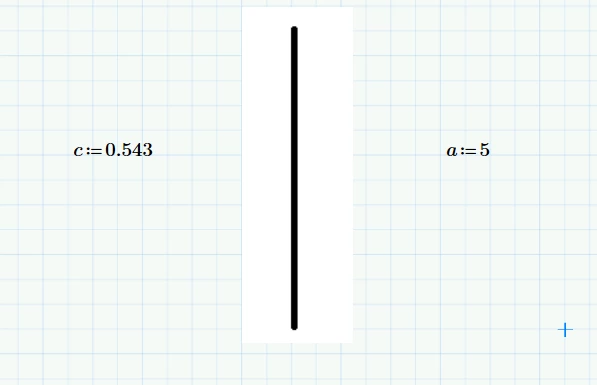

I assume to get the black line Luc just made a text box with consecutive vertical bars.  This was my first choice, too.  However, if you use ALT+179 you get a taller vertical line and can eliminate the spaces so it's one continuous line (may need to adjust font size).  Note that in Prime you'll want to press SHIFT+ENTER between lines instead of a regular ENTER (new line in current paragraph vs. new paragraph).
The only other way to get a vertical line that I can think of would be to make and insert a picture.
Either method will require you to manually add the line to each new page of the Mathcad sheet.
