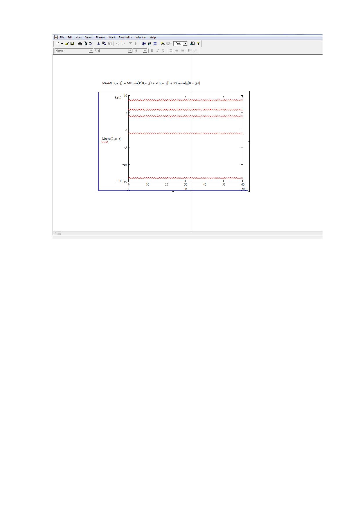

Yep, I didn't include any result because it takes too long for the program to arrive at it. Now I've included the plot I'm after - Mtotal(B). As you can see, it makes no sense.
In my opinion, dE() should return the energy minimized with respect to alpha and phi. I want to minimize the initial expression, that is, E(B,alpha,phi). I thought I minimized the E function by taking its derivatives and then finding their roots to be used for Mtotal... Should I have assumed a different approach? And how should I get the B range to have the desired effect?

Thats no surprise given the way the functions are defined.
In what form? a vector? a 61x2 matrix ? What did you had in mind?
Its a function in 3 variables, so you would need the derivatives wrt all 3. Also, how yould you cope with multiple (local) minima? And if you want the calculation being done for a constant B, I guess both partial derivates should be zero at the same time. I would suggest using either a solve block with Find() (using the two partial derivative) or one with Minimize().
I also don't understand why your function Mtotal should still be dependent on alpha and Phi and why you had setup ranges for those angles. f() and g() should already return the "optimal" values for those angles, as I think. Also f() and g() would not be dependent on alpha and Phi.

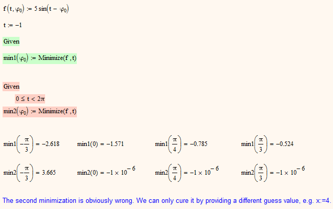

I had another look at my file and I noticed that Alan was right in that the parameter B, which is not optimized by minimize(), should be the last of the three, not the first.
I also added I third way to determine the minimum of E() (you already know that you can forget about the first one with the derivatives). Its a simple brute force algo which looks at each value in a grid of custom size and returns the angles which gives the minimum E-value. The results are (refrained from the first few values of B) pretty much the same as in Alan's sheet or with the second method in my sheet. We need a rather fine gridsize (grid>100) to avoid steps in the graph of Mtotal for higher B-values.
Anothe thing to mention: If we use minimize() we have to be very careful with constrains as those will give us wrong results with bad guess values.
I tend to call it a limitation of the numeric algoriothm rather than a bug.
