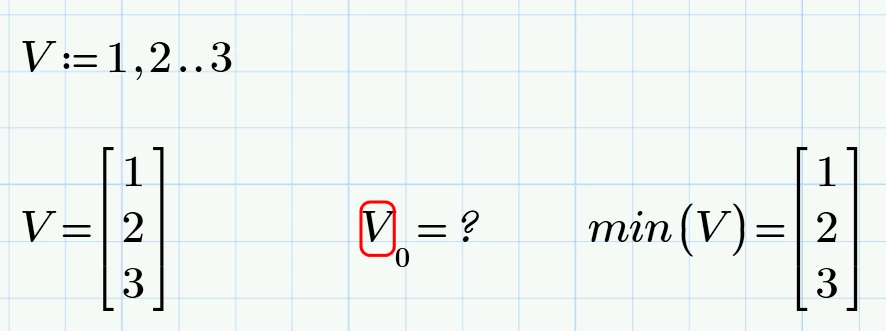

June 18, 2022

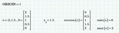

1. Range is Vector.
June 20, 2022
This idea is already implemented, albeit as an undocumented feature:
June 20, 2022
What version of Prime?

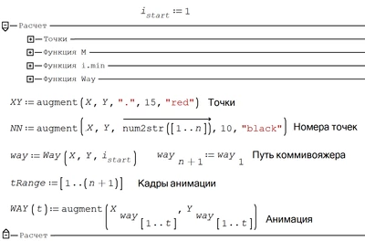

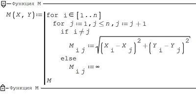

June 18, 2022
2. No <- for a local variable. Only :=.
June 18, 2022
3. Two variant of the for cycle

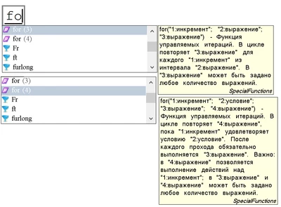

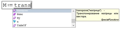

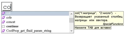

4. Dynamic help when I unsert variable, function or operator
July 12, 2022
Definitely this is something that Mathcad must implement, it is much more comfortable to read directly how the tools are used, in addition, the current descriptions that mathcad uses are really poor if not terrible

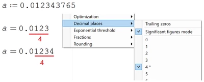

7. Number format: digits after point an common number of not 0 digits

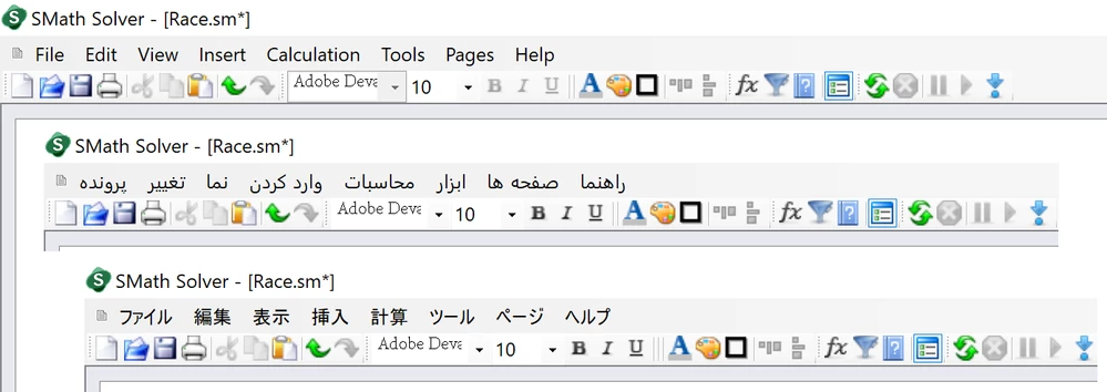

8. Two clicks for labguage chang

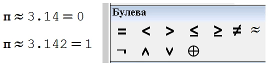

10. 7 not 6 boolean operators.
June 20, 2022
All my conscious life I dreamed that an operator would appear in the programs approximately equally. Such a program finally appeared, but not in Mathcad, but in SMath (version dated June 20, 2022).
Here is the only program in the world where the built-in operator is used, and not the user-defined operator is approximately the same!

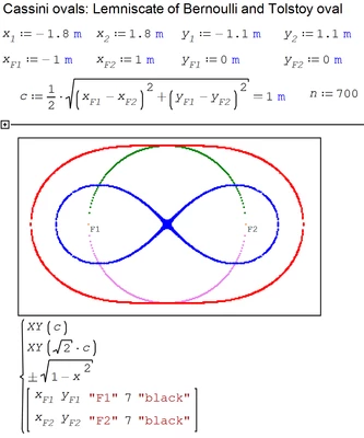

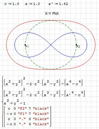

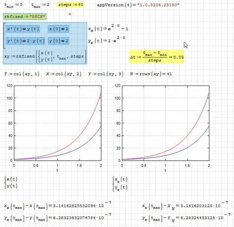

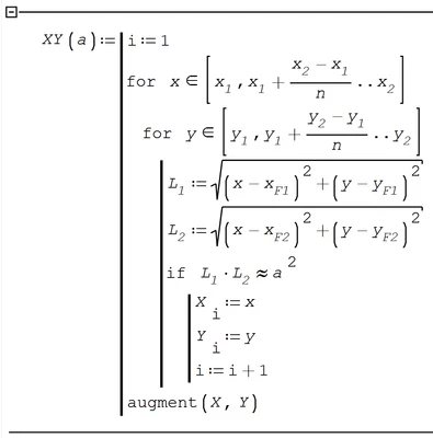

Expandability.
