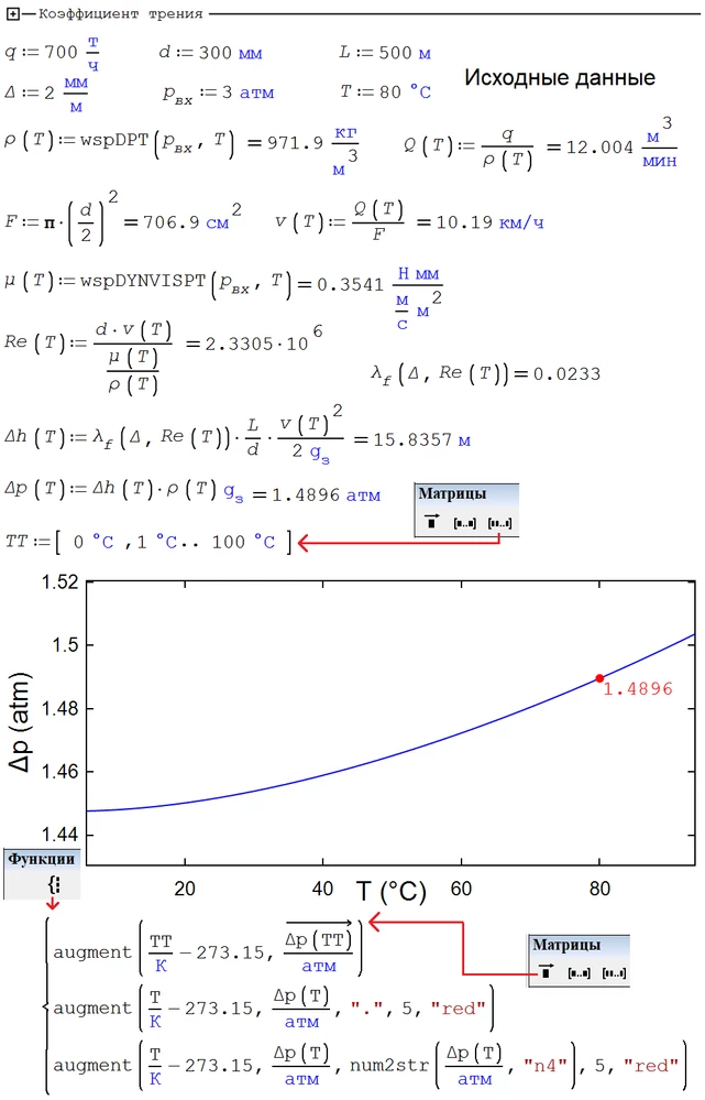

I will post pictures here describing some of the benefits of SMath over Mathad.
I ask those who have access to the Ideas section to transfer my drawings there.

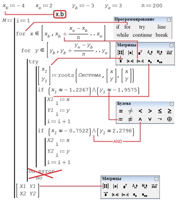

Aug 26, 2022 3:36 PM UTC
13. The system of equation solution in programs

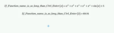

Mar 27, 2023 5:11 PM UTC
Ctrl+Enter breaks an equation onto the next line

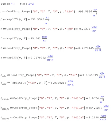

19. WaterSteamPro anf CoolProp as built-in functions
