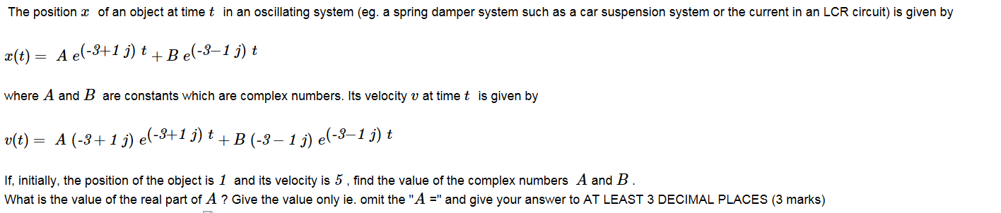

Hi - I'm not sure if I am doing this correctly - my question I am working on is :
So I know that x(t) = 1 when t=0, and V(t)=5 when t=0, so I use x(t)=1 on the 1st Equation and Solve for B so I get B=1-A
then I substitute 1-A for B in equation 2, set v(t) equal to 5 and t=0, Solve for A ......
However I'm not getting the correct answers so don't know what I'm doing wrong - can anyone help me on this one please ?
thank you

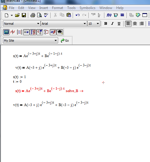

ccoldham1-VisitorAuthor
May 5, 2015 5:49 PM UTC
Hi Richard - I couldn't find the Use Advanced editor sorry - it's gone from bad to worse for me now as I tried to Solve for B but can't - I know that if I sub t=0 in for t then e^0 = 1 but I don't want to have to manually put that in like that. So I'm stuck
Would appreciate any help that you can give - thanks Christine.
23-Emerald I
May 5, 2015 7:28 PM UTC
To input a complex number, say 5 + 3 j, you have to type the following:
5 + 3 * 1j
The 1j (or 1i) is typed with no multiplier; this tells Mathcad that you're inputting an imaginary number.
