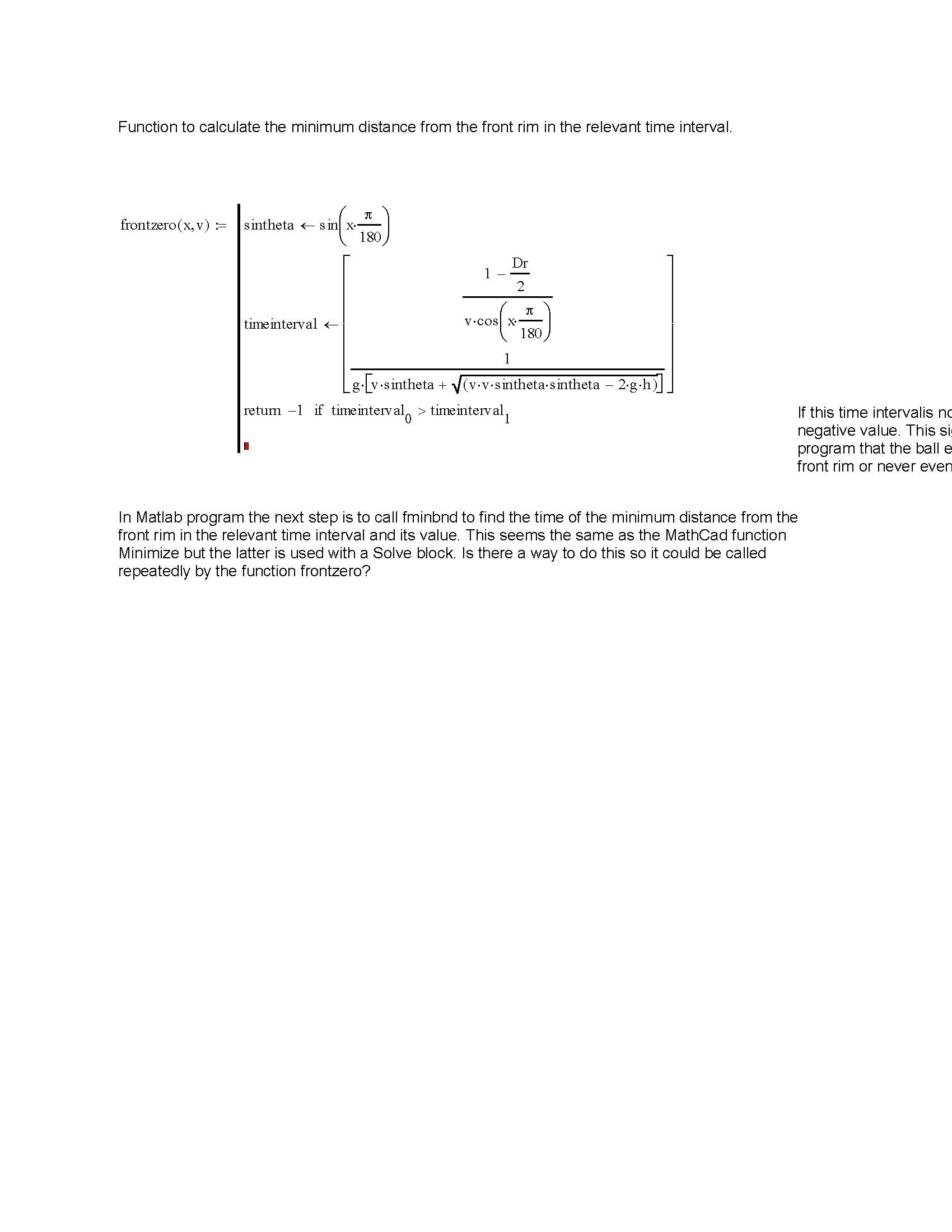

I am trying to translate some Matlab programs into MathCad. My question is highlighted below and the worksheet is attached. Thanks in advance for any help.

Yep, that dawned on me. Here it is...
Function+to+calculate+the+minimum+distance+from+the+front+rim+in+the+relevant+time+interval.jpg

You refer to the function fminbnd, but no such function exists in your worksheet. What is this function?
April 26, 2014
I guess I was not very clear. fminbnd is the Matlab function. fminbad (func, a, b) finds the minimum of func in the interval [a,b] (Note: funct depends on a single variable). I thought Minimize in MathCad was similar but had to be used with a solve block. Werner pointed out that it can be used alone, but now I see that it is for multi-variable functions. I guess I am looking for something like the MathCad function root, but for the minimum of a single variable function.

Which function do you want to minimize and in what interval?
A multivariable function would work with a single variable function as well, but I fear you want to minimize a function with more than one argument, vary only one of them and hold the others constant.
I remember that minimize made troubles when used in a program and it also cannot be turned into a function (as if I guesss right would be necessary here). It will also not work with locally defined functions.
You may write a brute force fminbnd(func,a,b) yourself but it would lack of precison and probably be rather slow.
