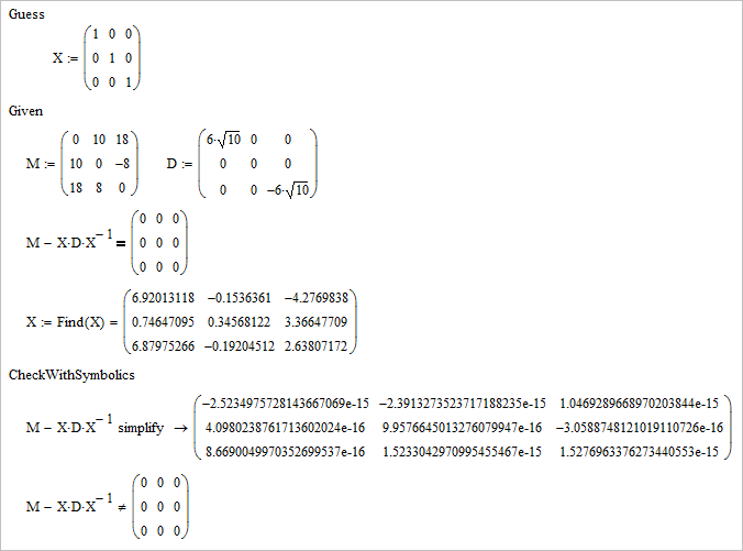

The question : Is there a way for symbolics solution ? ( for solve, X )
Thanks in advance for the time and help.

Evaluate Find symbolically
April 27, 2013
One test:

Yes! Do you have any reason to think that there exists a solution?
BTW, no guess values if you evaluate symbolically.
That way Mathcad does not know the structure of X (the reason for the "pattern match exception" in Valery's post) and you will have to tell MC in some way that X is a 3x3 matrix.
