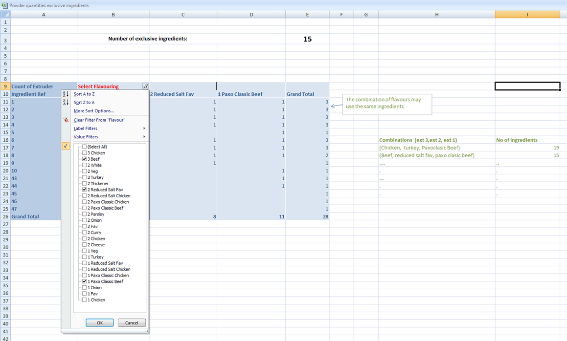

I have a problem whereby I have 25 different powder based flavourings of foods, each flavour is made up of a selection between 7-15 ingredients from a range of 51 different ingredients. Set flavourings are directed to three different extruders, 8 of these flavourings are directed to extruder A, 15 to extruder B, and 2 to C.
I’m looking to find the number of any combination of ingredients for any setup of all three extruders.
I have attempted it in Excel using Pivottable and select the three flavouring individually, which is fine if I need to know a specific setup, but it would take some considerable time to manually choose each combination of flavouring if I wanted to find the combination with the most ingredients.
I presume it is possible to display the results in a matrix format where the function was applied to all combinations. Also following this I will be adding data such as the combined weight of the mixes to determine maximum batch weight and selected ingredients. It would also be nice if i could display it in a 3D plot.

Aug 15, 2014 9:44 AM UTC
Yea sorry, i its quite difficult to explain my thought train, expecially when i am not familiar with these programs or how to explain in the right terminology.

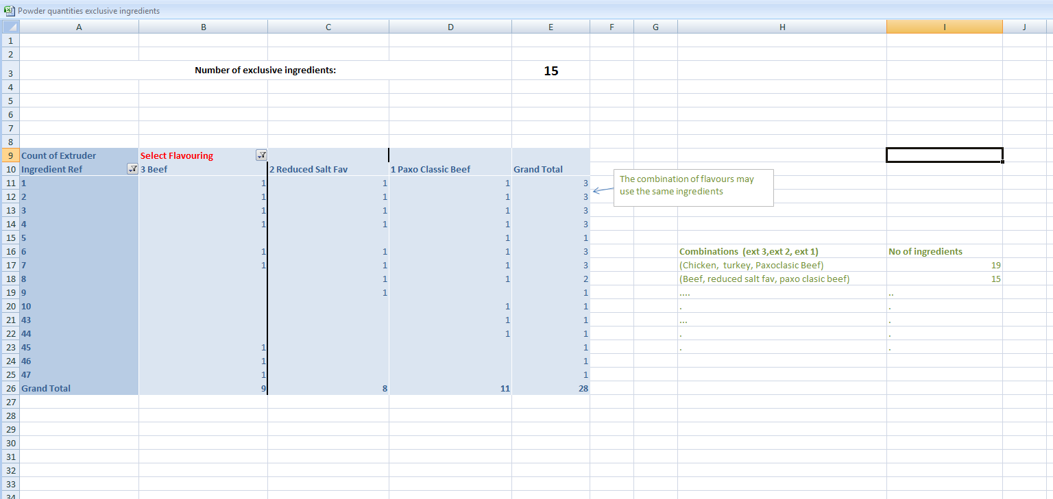

I've insered images of the excel doc where I originally attempted to solve this problem (not sure if i can attach a full .xlsx doument), hopefully this gives you an indication of what i am dealing with.
Capture3.PNGSelection of three flavours, one from each of the extruder lines so if i can somehow display the permutations/combinations* in a matracies then apply the function to this data to find the number of ingredients in each array, and then organise these to see which have the highest number of ingredients.

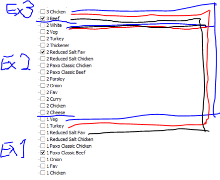

Ok, lets break this problem down, the image below shows the 25 flavourings, both beef and chicken on EXtruder 3, 14 flavours on 2 and 9 on EX 1. Am i correct at saying there are 252 combinations? If so is there a way of showing it in a 3D matrix?
Now each of these flavours comprises of a set ingredients, and I want to find a way of relating functions to the '252' combinations, so that I don't have to have to assess them individually.

Aug 15, 2014 2:54 PM UTC
There are 300 combinations for EX3 alone!
There are 25 different flavours that could go in the "top slot" in Ex3, For each of these there are 24 other flavours that could go in the 2nd slot in Ex3. This would give 25*24 = 600 combinations. However, we need to divide this by 2, to get 300, as each pair of flavours would occur twice in Ex3. For example, one combination would have Chicken in the top-slot and Beef in the 2nd-slot; while another combination would have Beef in the top-slot and Chicken in the 2nd-slot.
Where does your 252 come from?
Alan
