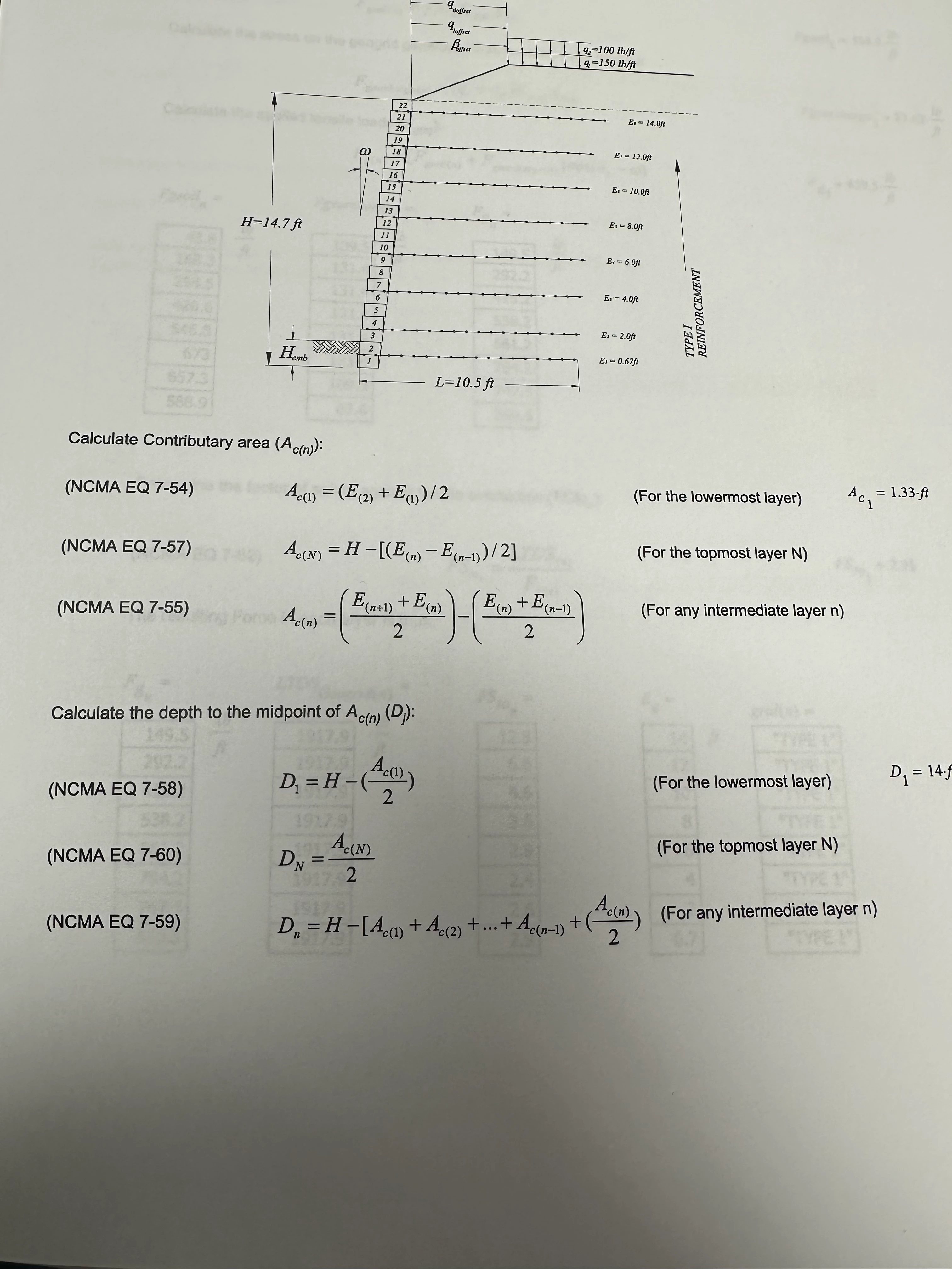

Hello all. I am not new to Mathcad but am new to matrices and evaluations. What i am trying to figure out is how to tell Mathcad Prime 9.0 to automatically select incrementing rows from a previous matrix for use in an formula. Please see the attached screenshot from a manual. I can define the E matrix without issue, but am lost after that. I have tried setting n = 0 and ORIGIN = 0, but that doesnt do what I need.

I am way out of my comfort zone, but as I understand it the  values in vector A.c should add up to H, which is not the case with the formulas given.
IMHO a sign in NCMA EQ 7-57 is wrong and it should rather be
In the picture posted by @JE_5076959  the "n"'s are wrong and should be "N"'s, as n is used as a variable index ( @terryhendicott  used "i" instead in his sheet).
This is correct given in the NCMA manual

Please attach your worksheet so we can see where you fail
terryhendicott
Nov 18, 2023 11:24 AM UTC
Here is one way.  Equations don't look right?
