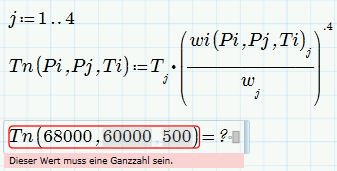

I have been having some trouble getting a function to work despite each individual part of the equation works and has the same dimesions as the other matricies in the equation. I have attached a file that demonstrates my issue. I want the function Tn to spit out a 4x1 matrix so it can be used in a later function. Please help!

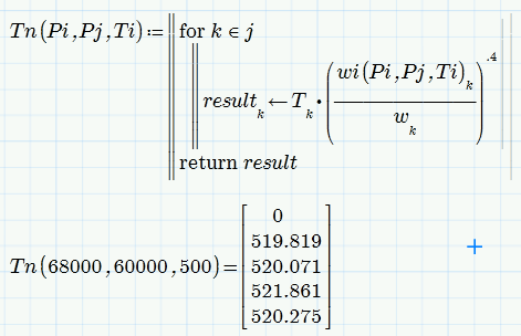

You have to be aware that Mathcad would begin the index count of vecors and matrices by 0. Thats the reason your 4-element vectors are 5x1 matrices with the first element set to zero. You should consider that fact and correct your indices accordingly. You can set the system variable ORIGIN to 1 to change that behaviour, but usually its a good idea to leave it at the default value 0.

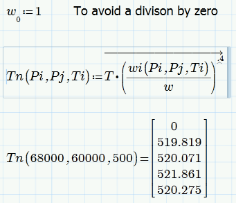

One way to achieve what you want is the following which does not make use of the range variable j, but uses vectorization. Note that setting w[0 to 1 is only necessary because of the problem described above. If you change your vector definition that would be no longer necessary.

expl1.pngError: "This value has to be an integer"
and you wondered why, as the same expression seemed to work OK if used on its own:

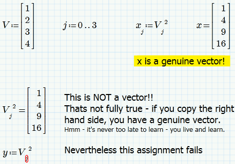

The reason is that, while the above result looks like a vector, it isn't !!! At least not a normal one you could use as any other vector. The range variable acts as sort of an implicit for-loop and what looks like a result vector is just Mathcads way to present the results of this loop. For some reasons they have decided not to create a normal vector in this situation but a construction which is rather useless for further calculations.
You can see that its not a conventional vector as you are not allowed to assign that expression to a variable

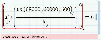

nor are you able to access a single element of that construction
expl4.pngError: "This value has to be a vector"
So one solution is to use Mathcads vectorization operator, which does the looping through the vector elements and creates a new vector as I showed in the last reply. Another way is to use Mathcads programming ability
