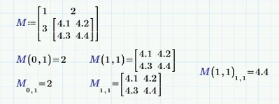

Let me tell you a story.  Once upon a time, perhaps even 10 minutes ago, when writing a new function (Bidiagonal) and testing it with strings, I replaced a direct function call argument with a predefined vector but forgot to remove the original function's argument.  After a few seconds of gazing at the (correct) output from Bidiagonal, I realised that the notation V(3) for vector V should have raised an error, but it didn't.
After a bit of playing with a new, blank worksheet, I confirmed that to get an array's elements, one can use the standard subscripted index notation Mi,j or the standard programming language parenthesis notation M(i,j). And Little Red Riding Hood and Peter campaigned for a better public understanding of wolves, their role in ecology, and their treatment.

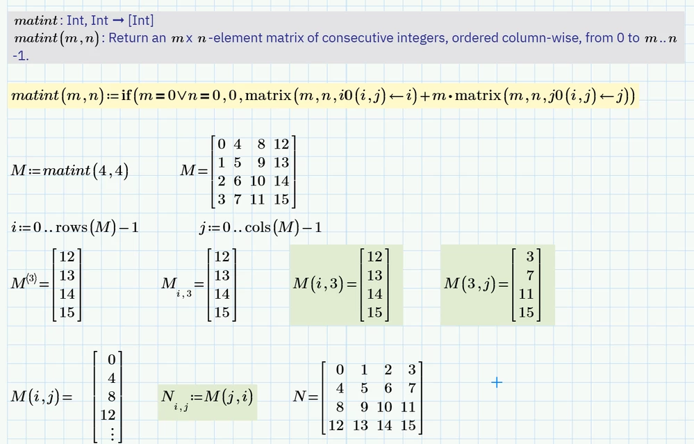

It is one of the two supported means to index an Array in Prime.
And it is confusing.
And it takes up more space.
And you cannot use this notation to access elements of nested arrays.
So I never use it

Yes, I agree, Luc.
I had a quick play with nested arrays but couldn't find a way of indexing them by extension of this notation.  I was rather hoping I'd be able to do something useful, such as P(1,1,1,1) to get at an element - that would make using nested arrays more straightforward and be the basis for a proper multidimensional array (MDA) system ... I may have mentioned/requested MDAs on the odd occasion.

Oct 20, 2024 12:57 PM UTC
Here is another difference - guess you did not try to change the value of ORIGIN.
The functional notation is ignoring the setting of ORIGIN - similar to the third argument (generating function) in the "matrix" function.
I can confirm that this 'feature' has existed since Prime's inception and I've railed against it a time or two here for a couple of reasons.
However, I haven't come across any official documentation on it, so I couldn't say that it's officially supported by PTC. It's also possible that it just happened unintentionally.
In my opinion, it would have made more sense to eliminate this 'feature'. Just as the undocumented ability to quickly and easily convert ranges to vectors was eliminated in Prime 10, but unfortunately without providing a (more logical and intuitive) alternative.

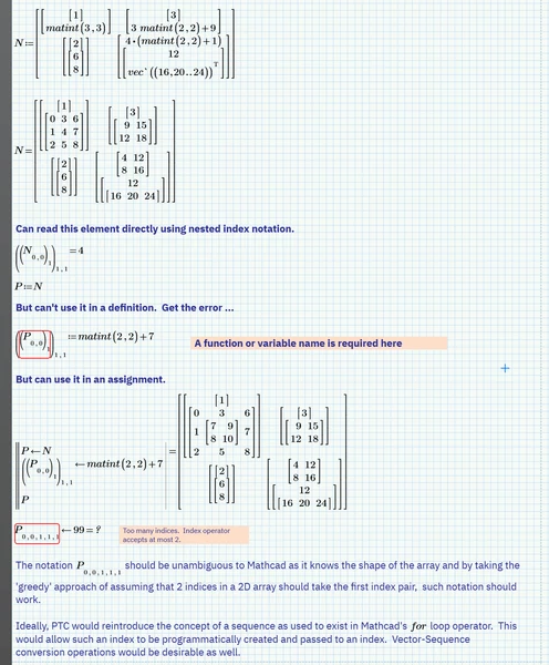

Whilst PTC are fixing this indexing feature, it would be nice if they'd give some consideration to fixing two particular bug bears I have with the normal indexing notation.
  • Cannot use deep nested array indexing on left hand side of a definition, although it works in an assignment.
  • Programmatically and visually, nested indexing, whilst unambiguous, isn't flexible enough to cater for irregularly shaped nested arrays.  The ability to use a single level indexing would make it easier to see the indices and to handle deep arrays.
ISTR that you couldn't use nested indexing in an assignment, either.  Did M15 or early versions of Prime allow it?

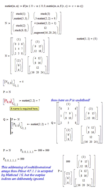

Oct 20, 2024 5:29 PM UTC
Here is what you did converted to Mathcad 15.
