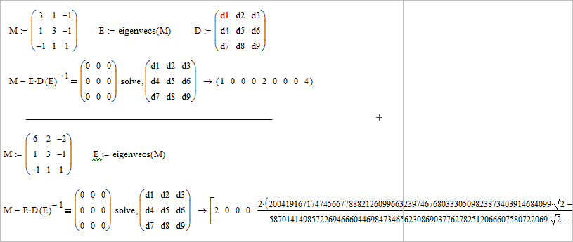

Hi Everyone,
I have a question :
Thanks in advance for the time and help.
Loi Le.
Best answer by AlanStevens
Why not just use D:=E^-1.M.E?
Alan
6 replies
October 7, 2012
You need to do something like the following:
Alan
lvl10720-TurquoiseAuthor
20-Turquoise
October 7, 2012
Thanks, Alan. But, also got... :
Loi.
October 8, 2012
Alan
