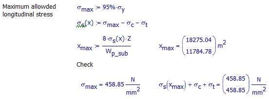

I am working through a simplified Pipe Stress calculation and having an issue with the Maximize function. I have tried to use the Maximize function to calculate the allowable free span of the pipeline, without success.
I am looking at the stresses in two pipelines and therefore require two results from the function. I have set up a Given/Find solve block without any issues. Can anybody explain if that a limitation of the Minimize function?
Cheers
Mike
Best answer by AlanStevens
How about the attached? Surely, sigma.s should be vectorised?
Alan

Mike,
From the Help file: "If you are solving for n variables, the solve block must have n equations"
Alan
January 26, 2012
I appreciate that Alan, but still this issue is driving me mad.
I have two values for sigma.c and sigma.t and I'm trying to find the maximum length that x can be (x is used for calculating the free span), so the combined longitudinal stressed do not exceed 95% yield.
M11 worksheet included.
Mike
January 27, 2012

I am actually solving for x, I'm looking for the maximum allowable span, which I have found using a Given/Find solve block, but I can't get the Maximize solve block to work.
Mike

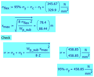

January 27, 2012
tmp.gifMIke,
(Thanks Alan, for how to use the solve block
My original comment was in error because I did not take the sq root to get xmax, but the point is that is easy to solve for directly. Why use a solve block?
Anyway, I get these lengths (Maybe I goofed)?
